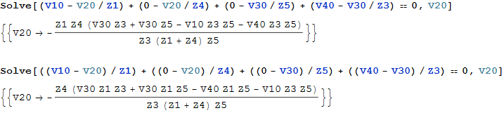

Although i look at part b of this question and i can see that I'm going to have to simplify a simultaneous equation full of them... great.
You can always simplify symbolically first. Plug in the complex values at the end.
