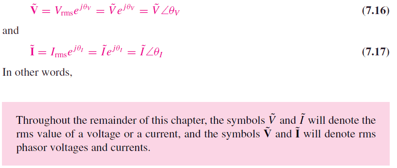

I'm reading this chapter in Electrical Engineering book regarding AC circuit analysis where there is a solved example which I've attached, but there are some concepts that are confusing me.
First, why and how do we know that the phasor value of voltage is: -pi/2
Note: I do understand that 14.14/√2 ≈ 10 but I don't get where -π/2 comes from?

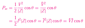

Second, earlier in the book and before the solved example the following formulas are stated:
So why in calculation of average power, the italic V and I are not used. Is that a mistake on the book? Shouldn't average power only be real number and not complex? Also in the solved example only real values of I and V is used, yet the V and I are not italic.
That's easy: ##\ \sin(\omega t) = \cos (\omega t - {\pi\over 2})##
bardia sepehrnia said:
  1. So why in calculation of average power, the italic V and I are not used. Is that a mistake on the book?
  2. Shouldn't average power only be real number and not complex?
  3. Also in the solved example only real values of I and V is used, yet the V and I are not italic.
I agree it's confusing. They make a mess of it in example solution 7.1..
  1. Yes. in example solution 7.1 it is clear that ##\tilde{\bf\text{V}}=10## and ##\tilde{\bf\text{I}}=2## and 7.16 & 17 wants ##\tilde V## and ##\tilde I##
  2. Yes. And it is; do you see it otherwise ?
  3. Isn't this the same question as 1. ?
You pasted a ##P_{\text{av}}= ... ## picture after the 'Throughout...' where they are more consistent .
