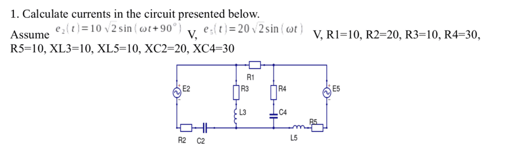

In this example, We need to covert e2 & e5 to a form with imaginary number .
we will obtain e2=j10 & e5=20
Can anyone explain how we got this?

It looks like you can write them down by inspection of the problem statement. your are given ##e_2(t)## and ##e_5(t)## right after the "Assume" in your problem statement. Can you say what the "j" means in ##e_2 = j10##?
it means i. Imaginary part

LOL, yes of course. Um, let me re-phrase...
Are you familiar with the phasor representation of a sinusoidal signal?
https://www.electronics-tutorials.ws/accircuits/phasors.html

BTW, it's hard to separate the "calculate the currents" part of the question from the "Assume" part and the part that you posted about "e2=j10 & e5=20 ".
To calculate the branch currents, I would use KCL equations to find the node voltages, but you can also use KVL equations if you prefer. But also, why would you say "e2=j10 & e5=20" when there also ##\sqrt{2}## terms in the time domain definitions?
The ##10 \sqrt{2} ## is the peak value of the sine wave. The RMS voltage for a sine wave equals $$ \frac {Vpeak } { \sqrt{2} } $$
RMS voltage is the equivalent to DC voltage. See link, below.
https://en.wikipedia.org/wiki/Root_mean_square
