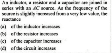

More than one options may be correct .
Inductive reactance =ωL
Capacitive reactance = 1/ωC
On increasing the frequency , inductive reactance increases whereas capacitive reactance decreases . Thus , option a) is correct .
But since net reactance of the circuit also increases , option d) should also be correct .
So I think both a) and d) are correct .
But this is wrong .

Which one is greater at very low frequency? XL or Xc?
What is the total reactance here? What happens to it when you increase the frequency 'slightly'?

I was missing the key thing ( " at very low frequency " ) and incorrectly assuming inductive reactance to be greater than capacitive reactance .Thus getting option d) .
I need to be more attentive while reading the question .
Thank you so much :smile:
