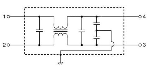

Most of the AC-DC converters I've worked with treat the two line inputs the same, ie both "neutral" and "hot" are interchangeable. This would also allow a single phase input to be either line-neutral connected, or line-line connected depending on available system voltages.
From an EMI perspective, generally a 3 wire filter is employed, and these also treat the two line voltage inputs identically:
I re read the question and now I'm not sure what you are asking...
