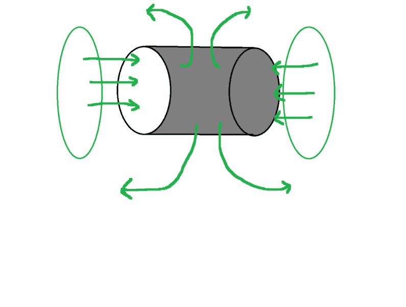

Ok, my setup is this , I need to fill a space with an RF AC B field , I am still making the setup once it will be finished I will be able to measure the capacitance and inductance of my system and determine the frequency range necessary, I will have the ability to change capacitance within a given range.
The dimensions are as follows, I need to have a homogeneous B field within a space of 7cm horizontal distance and 24cm vertical , the element is circular and 24cm is the outer diameter so it should be covered nicely by the field since the coils are also circular. well basically imagine a cylinder 24cm in diameter and 7cm long and I need this cylinder to be covered with a homogeneous B field, as for the strength for my experiment the stronger the better but I am looking forward to the formulas to understand what results I can practically achieve.

I'm unsure whether this then should be a really big cage in order not to deform the shape of the field too much. Anyone ?
If your 'element' under scrutiny contains iron, it is certain to deform the magetic field shape. No way it can remain uniform.

BvU well with guiding I meant to say that for a coil that has air as the medium through which B field permeates the B field strength will fall off faster than for a coil with laminated iron for example as the flux guide since air is rather bad at magnetic permeability compared to a laminated iron core , I do realize that at such high frequencies air is the only option otherwise I would have an inductive heater and my iron would melt if enough power would be applied to the RF correct?
Ok How about this version, can I make the B field homogeneous on a flat surface area near the coil because I don't need the field to actually be homogeneous all throughout the cylinder just at the ends and one more thing the field can be reversed from each coil as it can loop back through the middle. I'm sorry I specified the dimensions of my whole physical assembly I should have said that the field needs to specifically be homogeneous a few cm off the coil through a flat 2d surface what happens "further down the line" doesn't matter . I added a simple picture illustrating the idea, so being more specific the field only needs to be strong and homogeneous through the end surfaces which can be placed near the actual coils.
before I start calculating numbers in formulas is this even sound or do I have no chance of doing this at the Mhz frequencies with reasonable B field strengths?
