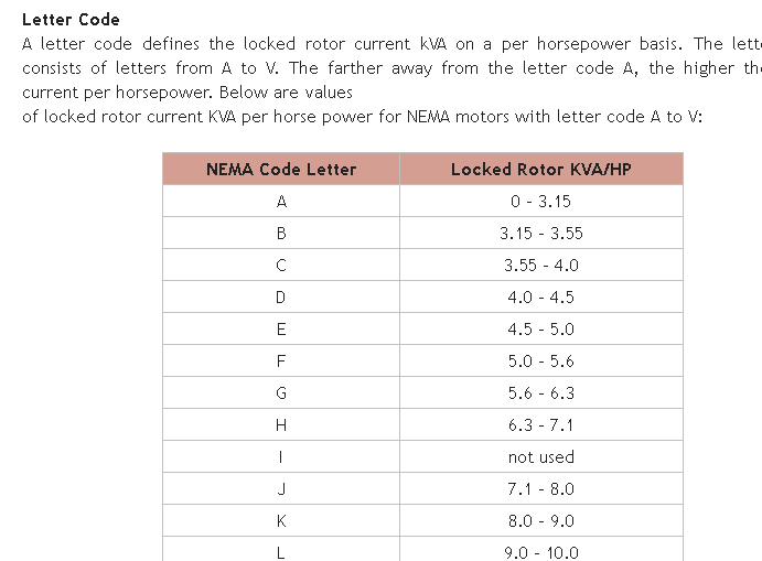

As to starting current
someplace on the motor nameplate should be an entry called "NEMA KVA Code" or similar
it's a single letter code telling you what is the starting current
you look up the value corresponding to the one letter code in a table
it's expressed in kva per horsepowerhere's the top half of the table, rest of it is in the link
244337
https://www.electricalengineeringtoolbox.com/2015/12/nema-locked-rotor-kva-for-three-phase.html
