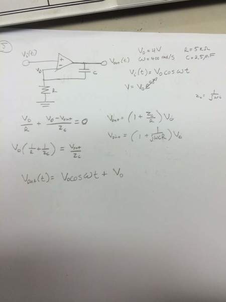

For vi(t) =V0 cosωt, obtain an expression for vout(t) in the circuit below and then evaluate it for V0 = 4 V, ω = 400 rad/s, R = 5 kΩ, and C = 2.5 μF.
For this problem, I am having difficulty taking that second term with the (1/jωRC)*V0 and transforming it back to the time domain

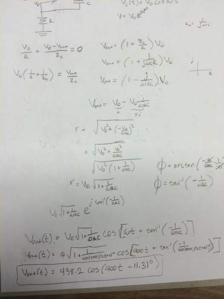

Here is my attempt

You have determined the transfer function, now express it as a gain of magnitude A and phase shift phi. Then apply that gain and phase shift to V0.cos(ωt)
That's where my problem is, I don't know how to make it into that expression
Two ways:
1. change your final expression to the form a + jb, then take the magnitude of this and determine the phase angle from the arc tan formula. Remember, the input is a cosine function.
2. change your final expression to the form r exp(jθ). r is your magnitude and θ is your phase angle. Again, the phase angle will be part of a cosine function, not a sine.
I seriously doubt I'm doing this right. All the examples in the book use numbers so I can't tell if I'm doing it right symbolically

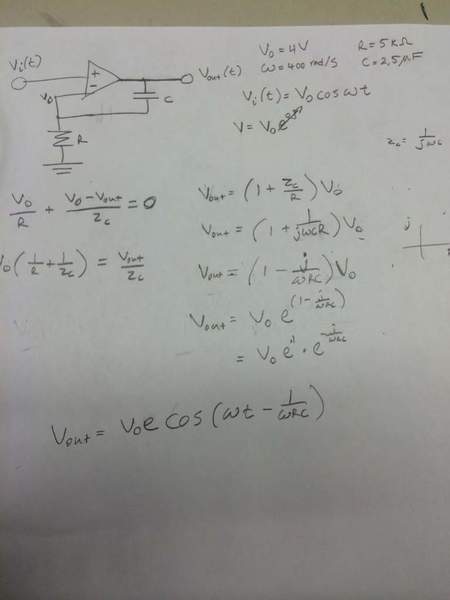

Ok I looked up an article on complex number magnitude here is my next attempt
I think you have the right approach. But it looks like your computation of r, going from the 1st to the 2nd line, is wrong. You forgot to square the ωRC term in the denominator? Hard to read the photo.
One more thing: if a voltage is V0cos(ωt) the phasor is V0/√2, not V0. This time it didn't matter but sometimes it does.
Finally: careful with your arc tan arguments. arc tan (-1/x) is not the same angle as arc tan(1/-x). I think you did OK there.

Thanks, I redid and fixed that calculation error.
We were working on it in office hours and my professor was stumped for a while. He thought that the input was equal to the output because you only take the real part of the phasor for the time domain, which at first glance appears to be just the input.
However, he forgot that its the real part times e^jwt

As rude man noted, you are not correctly calculating the magnitude of the complex gain. The calculation needed is to determinine the hypotenuse of a right-angled triangle when you know the base (the real component) and the height (the imaginary component), so use Pythagoras's Theorem.
Somewhere along the way you have forgotten to state that Vo= Vin
