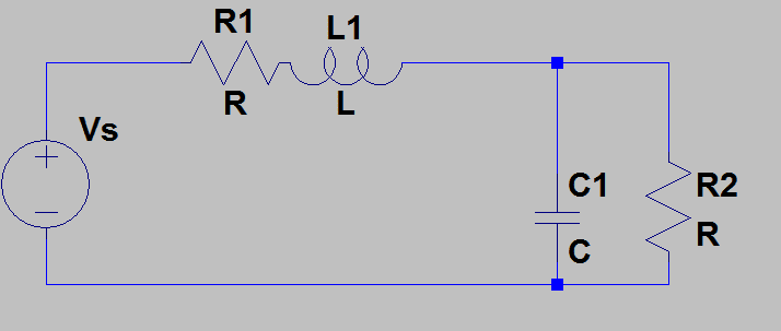

R1 = 12
R2 = 20
L = 0.0531H
C = 265.26*10^(-6)F
W = 2*pi*60
L -> jwL = 20j
C = 1/(jwc) = -j10
Mesh equations:
Mesh 1 (left mesh, clockwise)
-Vs +I1(R1+L+C)-I2(C)=0
Mesh2 (right mesh, clockwise)
I2(C+R2)-I1(C)=0
I1=6.78-j5.09
I2=-0.68-j3.73
Hand calculated:
PowerR1 = (I1 * I1conjugate *R1)/2 = 431W
PowerR2 = (I2*I2conjugate*R2)/2 = 143W
PowerL = (I1 * I1conjugate *L)/2=j719.87VAR
PowerC = -j297.79VARWhen I simulate in MATLAB, I get different results for reactive power of L and C:
Matlab provides these following RMS Voltages:
VL = 119
VC = 53.53
PowerL = ##\frac{VL^2}{L}## = -j719.87VAR
PowerC = ##\frac{V_C^2}{C}##=j297.79VAR
Is my MATLAB simulation wrong or my hand worked calculations wrong?

Matlab itself should let you write and plot functions, no? Your total circuit impedance is just:
##Z = R1 + ZL + \frac{R2*ZC}{R2+ZC}##
where: ##ZC = \frac{1}{jω C}##

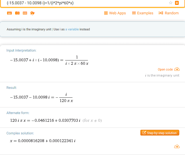

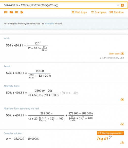

I am plugging in the original total real power and total reactive power. I cannot get the original value of capacitance.
Edit:
I used 576-430.8i instead and got the original capacitance value. How do I solve for C if I don't have a "defined" real power to solve for? Do I simply divide that by 2 (50%) as well?
  • #32
No, the real and imaginary parts of the power will have some complicated relationship.
Since you want to reduce the reactive power by 50% you can simplify things a bit by setting Vs = 1. Then ignoring units the current will be ##I = 1/Z## and the power will be ##P = V_s I^* = I^*##.
Isolating the imaginary part of ##I^*## might be tedious. You can write your impedance as:
##Z = 12 + j20 + \frac{1}{\frac{1}{20} + jωC}##
Might as well define ##x = ωC##, then
$$I = \frac{1}{12 + j20 + \frac{1}{\frac{1}{20} + jx}}$$
Normalizing that to pull out the complex component is not complicated, just labor intensive. Then find its value using the original capacitor value in x = ωC as the "benchmark" value for the imaginary component. You'll want to find a new value for x that yields half of that power.
