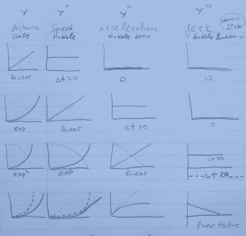

Thank you very much for your answer.
You are right that Hubble constant is not exactly just velocity, but velocity over distance and the derivative is more complicated than just the third derivative of the scale factor.
You mentioned that the third derivative is also positive and decreasing eventually to approach a constant positive value. In my graphs I think it is the last line, No4. Can you give a reference on that?
If this is the case then it doesn't fit with dark energy models that have constant dark energy per space, and as space expands dark energy is getting bigger with it, probably exponentially. In this case we should have line No3, with increasing second derivative and constant positive third derivative. The universe should then be exponentially accelerating.

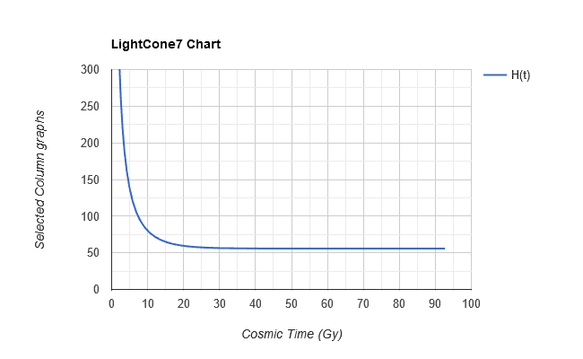

H does not seem to be constant. It breaks down to approximately 1/(age-of-universe), or at least it would if scale factor was linear. Point is, it is only constant because it's known to 1 significant digit and humans exist for too short span of time to witness a change in it. It was far larger in the past and will continue to slow.
For example, a thousand years after the big bang, something a megaparsec away would be massively beyond the size of the visible universe at the time and receding at thousands times light speed. A constant H would have it receding at 70 km/sec.
So what do you mean by H being constant in the far future? It's going down even though expansion is accelerating.

What was meant is what was written. It's going down towards a constant positive value (around ~57 km/s/Mpc, if LCDM is correct):
Technically speaking, it's always going to be decreasing, but the downwards slope quickly (in cosmological terms) becomes negligible and the expansion approximates to a de Sitter universe.
Likes The Count and Halc
So if I understood correct your answer with fixed Hubble parameter in the far future we should have (as scale factor is concerned) the forth line in my graph.
1. Space exponential expansion
2. The speed of that expansion first exponential and later linear (1st derivative),
3. Acceleration of expansion increasing in the begining, and reaching a fixed point in the future (2nd derivative),
4. As for the jerk (3rd derivative) positive in the beginning reaching zero later (lineary or exponentially?).
After you correct any misconseptions of mine, can you please provide a reference?

The Hubble constant with exponential expansion is constant in time, so all derivatives of it are zero. That is what the diagram @Bandersnatch posted is showing the dynamics approaching as a limit.

I am not sure I agree with that. Exponential expansion doesn't mean all the time e power that never goes away as you differentiate. It could be x^3 that goes to 3x^2, 6x, 6 and finally 0. That's why I keep asking which line of my graph charts you believe is best describing universe's expansion and you insist on not giving any answer. If you think that none of the lines are correct, please draw or describe a new one.
If exponential with e power is correct (according to ΛCDM) then we are concluding an expansion with accelerated acceleration (since all derivatives would be positive and exponential) which doesn't fit with your statement that density of dark matter is stable and this is what defines the dynamics. Because while the dynamics of expansion would indeed increase, from one point on (that all other energies are indifferent) the density will remain the same and the expansion rate should stop being accelerated (third derivative should be zero or approaching asymptoticaly zero).

I think there's some misunderstanding here. The lambda-dominated expansion is exponential of the form shown in post #3. It comes from the Friedmann equations; it can't be a power function or anything else - there's no wiggle room. You can find how it is derived, step-by-step, e.g. in Ryden, chapter 5.
It's hard to relate this to your charts, since - as was already discussed - they purport to show derivatives of the Hubble parameter, whereas what's being talked about are derivatives of the scale factor. Which in the lambda-dominated universe are all exponential functions, just with different constants in front. So I guess those graphs showing the exponents would fit, but then again, you label them oddly (what's exp^2 supposed to indicate?), and they're all in the column for the scale factor.
