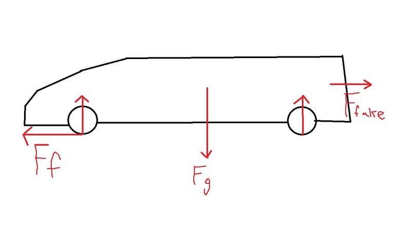

I made one in paint only, for now.
If the frame is accelerating, then we have a fictitious force. If the frame is inertial, then we only have that one force from the front wheels that makes the car accelerate. The other forces sum up to 0, it's the gravitational force and normal forces.
In the accelerating frame, we should have zero net force so Ff-Ffictitious=0
There is no need to go to the accelerating frame of the car. You can stick with the inertial frame of the earth.
Instead of drawing a force diagram for the entire car, draw a force diagram for one of the front wheels and draw a separate force diagram for one of the rear wheels.

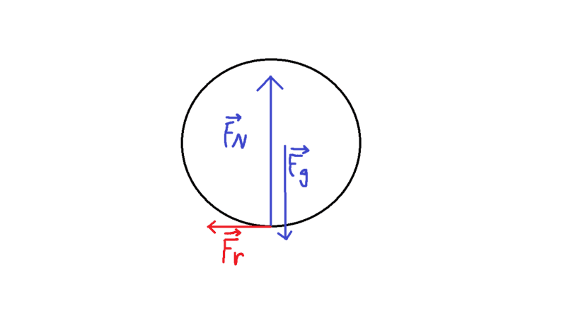

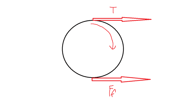

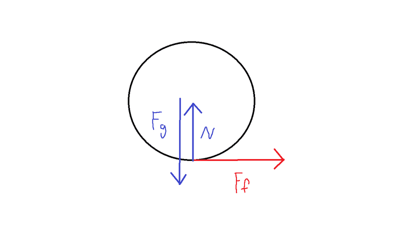

I made pictures with torque and friction, do they look familiar?
The diagram for the front wheel needs a little clarification. There would be forces on the wheel in the vertical direction that you did not show. The friction force appears to be in the correct direction if you are thinking of the car as moving to the right.
What does the arrow labeled by T represent? Arrows on a free body diagram indicate forces. Is T a force?
The diagram for the rear wheel also has the correct direction for the friction. But, again, I'm not sure what the arrow with the T represents. There are also some vertical forces acting on this wheel.

I fixed the wheel diagrams to be more clear now, right is positive movement.

They look pretty good now. For the front wheel, you should indicate that there is a torque applied by the engine. This could be a curved arrow labeled by τ where the arrow is clockwise or counterclockwise (you decide).
But, if you get the energy equation set up correctly, then you will not actually need these diagrams.

Your diagrams look correct. But I recommend using different notations for the friction forces on the front and rear wheels.
