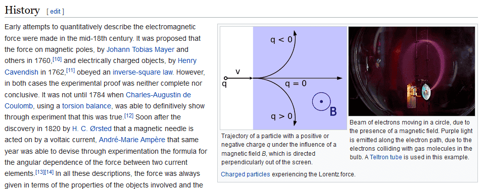

Are you familiar with the Lorentz force? The more familiar you are with that concept, the easier it will be to answer your questions about this.
Also, have you looked at the CERN website to see if they have some good basic explanations for how that accelerator works? (I have not looked yet, but it seems like they should have something...).
https://en.wikipedia.org/wiki/Lorentz_force
