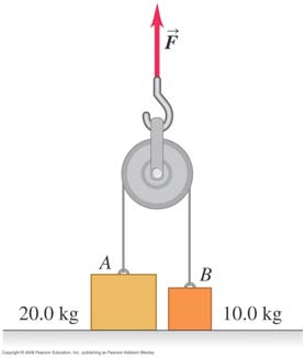

I have all the footwork (equations) under control, but I can't figure out how the forces are divided in this situation:
There is a force applied upwards.
When the force F isn't great enough to move any of the blocks, the force on A and on B both equal ½F (since the pulley's strings are parallel to the direction of F)
Now, we increase the force F so that ½F > Weight of B, meaning B accelerates upwards, while A remains at rest.
Now my question is:
how does F split up? Does F exert the same amount of force on B as on A?
And also, if F is great enough to move both blocks off the ground, is F still exerting the same amount of force on A as on B? (excluding the amount of force that A will exert on B and opposite)
I thought about this the whole day, and couldn't make up my mind between two possible ways that the force could be split in the pulley.
The first idea was that the force, no matter what, is split 50/50.
The other idea was that if there is any acceleration, the force coming from F will split as follows: (mA and mB are masses of the blocks)
F(on A) = mB/(mA+mB)*F
F(on B) = mA/(mA+mB)*F
This means that the force on the heavy block is smaller than the force on the lighter block. And together, they make up F
This makes most sense to me, but my physics book doesn't say anything about it :rolleyes:

Basically, I have a force F = 424 N and I need to find the accelerations of each block.
To solve it, I gave block A an unknown force upwards + tension in the rope - weight. Block B I gave a different unkown force upwards + the same tension on the rope - weight.
So, to solve it, i need to know how F splits into the two unknown forces. That's all i need.

The only forces on the blocks are the tension the weight... there is no other unknown force... can you explain why you think there's another force involved?
The tension in both cords is the same. First get the tension using the freebody diagram of the pulley...
What is the net force on the pulley? Solve for tension...
Then using the tension you can get the acceleration of each mass.
You say "both cords", but we all know there is only one cord... which is why I'm getting confused.
If there were two cords, and they were simply fastened to the upper rope without a pulley, then the downwards force in the free-body diagram for that junction of ropes would contain the sum of the tensions from each lower rope.
But since it's a pulley, I'm confused how the tension works... is the downward force 2T or just T ?

It is one cord, but there are two forces involved for each part of the cord on each side of the pulley...
In this particular case those two forces are the same... ie the tension on either side of the one cord is the same... generally this is not true... it is only true here because the pulley massless.
The downward force is 2T.

No. this isn't right. we are looking at the freebody diagram of the pulley. you shouldn't have mA or mB here...
F - 2T = mpulley*apulley.
So since the pulley is massless, the net force will be zero. Meaning T = ½F.
