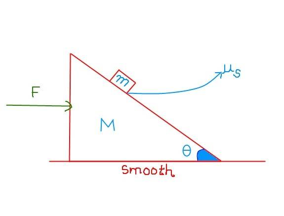

In the figure a block of mass 'm' is placed on a wedge of mass M. The wedge is subject to a horizontal force 'F' and slides on a friction less surface. The coefficient of static friction between the block and wedge is μs. Find the range of values of 'F' for which the block does not slide on the incline.
If the bodies (block+wedge) move together then:
F=(M+m)a
If 'F' is too less, then the block of mass 'm' will have a tendency to come down the incline.
If 'F' is too much, the block will have a tendency to move up the incline.
So 'F' need to be in between these minimum and maximum values and that's how we get the range. But my doubt is that why do the above 2 conditions i.e when F is too less and when F is too much happen?
Why or when? Are you able to write out and solve the equations?
Note that in the case of sliding down, it may be that F needs to go negative if the angle is low or the friction is high.

andyrk said:
Can the reason for why the block moves up the incline and down the incline be explained without using pseudo force method and just normal application of Newton's Second Law?
Of course. Applied corectly, inertial frames and non-inertial frames should lead to the same answer. It's only a question of which is more convenient.
So how would one do that? I am not able to think of an explanation without using Pseudo Force which explains why the block moves up or down the incline depending on the magnitude of the force.
Down the incline is ok, yes? If little force is applied and the friction is weak it will slide down.
For the block to slide up the incline, it is only required that the horizontal acceleration of the wedge exceeds that of the block. We can make the wedge accelerate as fast as we like by applying a large enough force. The acceleration of the block in that direction depends on the normal force from the wedge (limited by g) and the frictional force (limited by g and mu).

andyrk said:
Friction comes into play when the block slides. But why would it slide in the first place?
Static friction applies well before the block slides.
Here's the plan:
Three unknowns, normal force N, friction Ff, acceleration a.
Three equations, horizontal F=ma for the wdge, horizontal and vertical for the block.
Solve to find Ff/N as a function of M, m, F, theta and g.

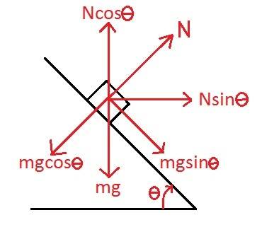

For simplicity, consider the case where there is no friction. If the force F applied to the wedge is large enough the block will slide up the incline. But note that in the inertial frame, the block slides horizontally in the same direction as the wedge while it also has a vertical component of displacement. Considering the directions of the two forces acting on the block, it should not be too surprising that the block can move this way.
Why does it have a vertical component of displacement?
The normal force on the block has a vertically upward component. If the applied force F on the wedge is increased, what do you suppose happens to the magnitude of the normal force on the block? What happens when the vertical component of the normal force exceeds the weight of the block?
The block flies off and leaves contact with the wedge. But still, we don't have any force along to incline to make it slide upward or downward. And anyway, the normal force would never exceed the weight because normal force is by definition always equal to the force with which the block is pressing against the wedge.
The normal force can exceed the weight because of the acceleration. The only way to settle this is with equations. Have another go at them.
andyrk said:
The block flies off and leaves contact with the wedge...And anyway, the normal force would never exceed the weight because normal force is by definition always equal to the force with which the block is pressing against the wedge.
The block does not leave contact with the wedge. When you stand in an elevator that accelerates upward, the upward normal force on you is greater than your weight. But you don't lose contact with the floor. (The elevator accelerates with you.)
There does not need to be any force component upward along the incline in order for the block to increase its height on the wedge. If you vectorially add the normal force and weight, you get a net force on the block that points upward and to the right (if the normal force is sufficiently large). So the block accelerates upward and to the right while remaining on the wedge, as shown in the figure I previously posted. If you add in the friction force, you should still be able to see how it is possible for the block to increase its height while remaining on the wedge.
But I think I might be detracting from the main point of setting up and working through the equations.
The equations are: Ncosθ = mg and Nsinθ = mA. None of these forces are along the incline so how can the block slide up or down the incline?
Since there is no friction force in these equations, we must still be considering the case of no friction.
When you write Ncosθ = mg, you are assuming at the outset that the block will have no vertical acceleration. In that case, the block can naturally remain in one place on the incline and not slide up or down the incline as the wedge is pushed. But, note that Ncosθ = mg tells you what N must be for this to happen. Using this value of N in your second equation will determine the specific value of A that must occur in this case. From that you can get the specific force F that needs to be applied to the wedge so that the block will not slide up or down the frictionless incline. So, only if you push the wedge with this one specific value of F will the block not slide up or down the incline. If F is greater than this specific force, the block will slide up the incline; if less, it will slide down.
