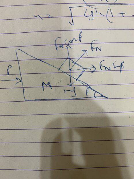

A wedge and a block are moving on a smooth horizontal surface such that the block of mass m is at rest with respect to wedge of mass M. The magnitude of applied force P
##F=ma##
I have drawn a fbd and the logic I think is that at rest the block moves down the wedge but when a force P is applied vertical force becomes zero and the horizontal force ##F_N\sin \beta## = P?
What vertical force becomes zero?
This is not correct (except in the limit where the mass M of the wedge goes to zero).
Using a free body diagram for the block and Newton's second law, you should be able to derive an expression for ##F_N## in terms of ##mg## and ##\beta##, and also an expression for the acceleration of the block in terms of ##g## and ##\beta##.
The vector sum of vertical normal component and mg is zero.
I am not fully grasping the mathematical eqn of what you want to say but the force P will be greater than the ##F_N \sin \beta##. You certainly don’t mean ##\lim_{m \rightarrow 0} {F_N \sin \beta }=P## ?
TSny said:
Using a free body diagram for the block and Newton's second law, you should be able to derive an expression for FN in terms of mg and β, and also an expression for the acceleration of the block in terms of g and β.
##F_N \cos \beta=mg##
##F_N \sin \beta=ma##
After solving, ##a=g\tan \beta##
##P=Ma=Mg\tan \beta## ?
##P=Ma## ?
No.
Remember, ##F_N## is an action reaction force. As a result, ##P## is not the only force exerted to the wedge.
Good
No. See post #9 by @Rikudo
##F_N\sin \beta=ma##
##P-F_N\sin \beta=Ma##
##P=ma+Ma=(m+M)a##
I get it. P is the force acting on a body of mass ##(m+M)## due to which it accelerates with acceleration ##a=g\tan \beta##. Correct amount of force P is causing the two bodies to behave as one like they are glued together. Not less and not more.
Putting the value of a from post#8, we get
##P=(m+M)g\tan \beta##.

I think you are correct now but You made a small algebraic blunder in your last equation.
if M=0 then from your fourth equation $$P=mg\tan\beta=F_N\cos\beta\frac{\sin\beta}{\cos\beta}=F_N\sin\beta$$
Likes rudransh verma

Well and I can't understand how you end up with that ##\cos^2\beta## in the denominator.
Isn't it (according to your equations in post #8 $$F_N\cos\beta=mg$$ and of course $$\tan\beta=\frac{\sin\beta}{\cos\beta}$$.
Substitute those in the equation $$P=(m+M)g\tan\beta$$ and you get $$P=F_N\sin\beta$$ after some high school algebra and under the condition M=0.

I understand that you are right but ##P=mg\tan \beta##
##=\frac{mg \cos \beta \sin \beta}{\cos ^2 \beta}##
##=\frac{F_N\sin \beta}{\cos ^2 \beta}##
Where am I going wrong?
Look more carefully in your equations, it is (under that M=0) $$P=mg\cos\beta\tan\beta$$.
But ##F_N=mg \cos \beta##?
You made the mistake of assuming that ##mg \cos \beta = F_N##. The correct relation is ##mg = F_N \cos \beta## as you had in post #8.
(In many inclined plane problems, we do have ##mg \cos \beta = F_N##. But not in this problem.)
Likes Delta2
Seems I blunder too in post #19, I meant to write $$P=F_N\cos\beta\tan\beta$$.
TSny said:
You made the mistake of assuming that mgcos⁡β=FN. The correct relation is mg=FNcos⁡β as you had in post #8.
Oh yes! ##F_N## > ##mg\cos \beta##.
Thanks everyone!
