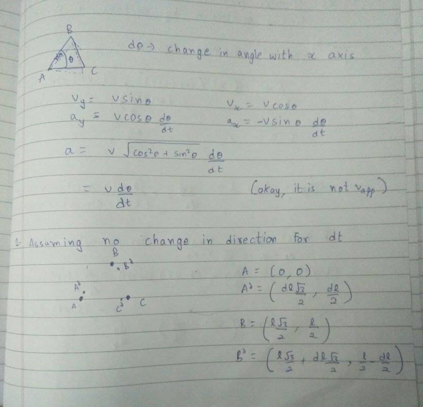

Three particles A, B, C, are situated at the vertices of equilateral triangle of side l. They approach each other with velocity v, such that A always moves toward B, B towards C and C towards A. What will be the initial acceleration?
Using vector components, I have found the acceleration
a=vapproach*(rate of change of direction of velocoty vector
a=(3v/2)*(dθ/dt)
However I could not calculate this rate. I have tried to form trigonometric relations and differentiate them but it failed, and I am out of any new ideas.

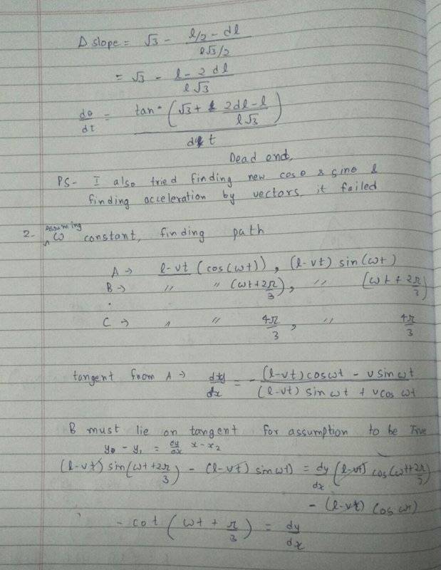

I have tried assuming that they move dl distance along the stright line in dt time, ignoring the direction change. Then I used co-ordinate geometry to find the new slope and calculate d(theta). I was left with a value that had terms of dl and dt, and hence useless
I made another attempt at it.
I assumed that the triangle that forms between the three, rotates with a constant angular velocity. This too yielded nothing.
This is the working for that https://m.imgur.com/gallery/9X34cs1

I assume that for dt time they don't change their direction and move in straight line.
$$\text{Initial slope}=\sqrt{3}$$
$$\text{Slope after }dt=m _2$$
$$d\theta= \tan^{-1}
\left(\frac
{l*\frac sqrt{3} 2 -dl \sqrt{3}} {\frac l 2}}-sqrt{3}\right)$$

It is V^2/r, but i will need radius of curvature to do that here, for which i will require the eqn of their path, which i haven't got. I tried doing it in reverse assuming angular velocity constant but that led nowhere.
Do you have any idea for the path followed

You have made a mistake in the latex and I cannot figure out what you meant.
But I think there is an easier way than working with slopes.
Suppose B has moved to position B'. AB and AB' will be almost the same length. (You can make an approximation for for the difference if you like.) using the lengths AB' and BB' and the angle ABC, what expression can you write for angle BAB'?
Likes Raghav Agarwal
I have tried fixing that latex mistake But i can't find it. I have written it out and posted in #15, this time a bit more clearer.
Using that
$$d\theta=vdt/l$$
$$d\theta/dt=v/l$$

I was thinking of the sine rule: vdt/sin(dθ)=AB'/sin(60)≈AB/sin(60).
And sin(dθ)≈dθ.
Because of symmetry, the three points are always on the corners of concentric equilateral triangles, shrinking and turning in time. I would work with polar coordinates.
The shaded angle is 30°, so the radial component of the velocities is ##\dot r= v\cos(30)##, the angular component is ##r\dot \theta = v\sin(30)##. Use the expression of the acceleration in polar coordinates. https://en.wikipedia.org/wiki/Polar_coordinate_system#Vector_calculus

In post #20 I have given you equations by which you can very quickly find dθ/dt.
