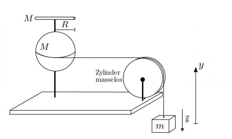

Hi everybody! Still checking my comprehension of physics, and hopefully those posts will help other users!
A homogeneous wooden sphere with mass M and radius R rotates about a perpendicular axis going through its center of mass. At the top of this axis is a homogeneous metal bar of length 2R and of same mass M. A massless string is rolled around the ball (see attached picture) and on its other end goes through a wheel and has a suspended mass attached to it. There is no friction.
a) calculate the moment of inertia of the system wooden ball-metal bar regarding its rotation axis. The bar should be considered as infinitely thin. The moment of inertia of a sphere is JK = (2/5)MR2.
b) what is the acceleration of the mass m in the field of gravity of Earth?
c) what is the velocity of the mass m when it has gone down a distance h?
Moment of inertia, torque, Newton 2nd and 3rd laws, conservation of energy
Though it is not the hardest problem, I find the calculations messy and the risk of missing something high. Here is what I've done:
a) First I calculate the moment of inertia of the bar:
JS = (1/12)M(2R)2 = ⅓⋅MR2
⇒ Jtotal = (2/5 + ⅓)MR2 = (11/15)MR2
Im pretty sure I can add the moments of inertia that way since they have the same axis of rotation, right?
b) By Newton's 3rd law I know that the force of tension of the string on the mass is equal to the force of tension of the string on the sphere. I try to find an expression for T using the torque and the angular acceleration:
Στ = T⋅R
⇒ α = Στ/J = 15T/11M
The angular acceleration is also equal to tangential acceleration/radius aT/R, and in that case aT = a (the acceleration of the suspended mass):
⇒15T/11M = a/R ⇒ T = 11aR/15M
I plug that into the Newton's 2nd law:
a = ΣF/m = g - 11a⋅m⋅R/15M
a = g/(1 + 11m⋅R/15M)
c) For that part I set up an equation of conservation of energy. I assume that the system starts at rest:
m⋅g⋅h = ½⋅m⋅v2 + ½⋅J⋅ω2
Is that correct? I have a little doubt about the rotational energy.
Then I substitute ω by v/R. Here again I have a little doubt: I allow myself this substitution because I think the velocity of the string at the sphere should be the same as the velocity at the mass. Anyway that gives me for the velocity:
v = √(2⋅m⋅g⋅h/(m + 11M/15))
What do you guys think? It's always a bit tricky not to misjudge such a situation..Thank you in advance for your answers!Julien.
Yes. Jtotal looks good.
Στ = T⋅R
If you mean M to be in the denominator, then you should use parentheses: 15T/(11M). However, this expression is not correct as you can tell by the dimensions. Did you get all the factors of R taken care of?
Again, you can check the dimensions of the last term in parentheses and see that this cannot be correct. Is little m equal to big M? If so, you can simplify.
Your work for (c) looks good to me. Again, you can simplify if m = M. You can also check whether or not the answer for (c) is consistent with (b) by using the acceleration to find the final v.
Likes JulienB
@TSny Thank you for your answer. I've reviewed the calculations and I indeed forgot a factor R. I now get T = (11/15)a⋅M and therefore a = g/(1 + 11M/(15m)). I believe the units are consistent this time.
Unfortunately as far as I know m ≠ M, so I cannot simplify any further, but the R I forgot already simplified the expression a little bit since it does not depend on it anymore.Julien.
OK. Your answers look right to me. You can check some limits to see if it makes sense. If M goes to zero, what is a? If M goes to infinity, what is a? If m goes to zero, what is a? If m goes to infinity, what is a?
Likes JulienB
@TSny thanks I'm always fond of ways to check the consistency of an answer!
- if M goes to 0, then the acceleration is g. Makes sense since the mass m would not be held back by anything then.
- if M goes to infinity, the acceleration goes to 0. Makes also sense since m would then be held back by a much heavier mass.
- if m goes to 0, the acceleration also goes to 0. There is no more mass on which to apply the force of gravity,
- if m goes to infinity, a also goes to infinity. The force of gravity being applied onto an infinitely heavy mass, that also makes sense.
