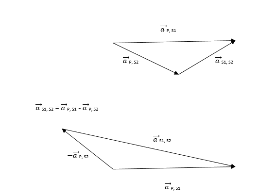

vela said:
Good. You're interested in ##\vec a_{S2,S1}## which is equal to ##\vec a_{P,S1} - \vec a_{P,S2} = \vec a_{P,S1} + (-\vec a_{P,S2})##. In your diagram, you simply need to reverse the direction of ##\vec a_{P,S2}##. It's probably easier to see in a triangle diagram than in the parallelogram diagram.
Now consider how you can orient ##\vec a_{P,S1}## and ##-\vec a_{P,S2}## to maximize and minimize the magnitude of ##\vec a_{S2,S1}##. Just fix the direction of ##\vec a_{P,S1}## in the x-direction and vary the direction of ##-\vec a_{P,S2}##.
Is this right ? I reversed the direction of ##\vec a_{P,S2}##, so when ##\vec a_{P,S2}## and ##\vec a_{P,S1}## point at opposite directions, we get maximum ##\vec a_{S1,S2}## and we get minimum(zero) ##\vec a_{S1,S2}## when ##\vec a_{P,S2}## = ##\vec a_{P,S1}## ?
Somebody please confirm if the vector diagram is right, I need to make notes. @kuruman you have something to say ?
Both diagrams are wrong. You made the same mistake earlier in the thread. See posts 5 through 9.
That said, your reasoning about the range of magnitudes of ##\vec a_{S1,S2}## is correct.
I'll add that you really shouldn't need us to confirm the correctness of your answers. You need to construct your understanding so that you can be reasonably confident on your own that an answer is correct, not relying one some authority to tell you that.
Likes Monsterboy and Orodruin

  • #35
I haven't studied physics since 2010 and that was just basic stuff, so anything I think is correct is probably not.
Anyway, I hope the below is correct.
  • #36
Monsterboy said:
I haven't studied physics since 2010 and that was just basic stuff, so anything I think is correct is probably not. Anyway, I hope the below is correct.
We all make mistakes, so it's important to develop the ability to check your work and find those mistakes. For example, when you drew the first diagram, you could have also written down the equation it represents by interpreting the diagram. Then you would have hopefully seen the subscripts were messed up and realized the diagram had a problem. By getting in the habit of looking at the same concept in different ways, you'll start to see how they all fit together.
Monsterboy said:
The second diagram is still wrong.
Likes Monsterboy
  • #37
Ok, when I tried parallelogram, I figured I was putting ##-\vec{a}_{P, S2} ## on the wrong side.
This must be right.
  • #38
That's right. :smile:
Likes Monsterboy
  • #39
Thanks all, for the support!
