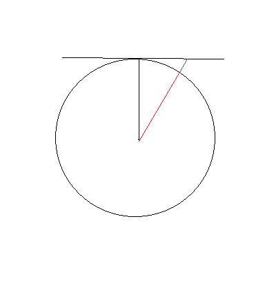

so do you mean that the small distance (in blue) + the radius (in red) is what should have been the distance from the centre to the object if centripetal force was not acting, but, if centripetal force was acting, the small distance (blue) would be the apparent decrease in radius. even though the radius remains constant, it looks as if it is decreasing with respect to the initial point (provided the distance between the points is Rdθ, R is radius).

You can think of it that way. Even better is to think directly in terms of the change in velocity, as described here: Circular Motion and Acceleration
