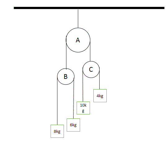

Acceleration due to *equal* weights on pulley system
In summary, the problem involves three pulleys and four masses, with pulley B being assumed to go down and pulley C to go up. The tensions in the strings over pulleys B and C are assumed to be equal, denoted by T. Three different tensions are to be considered, one for each string connecting the masses. The accelerations of pulleys B and C are assumed to be equal, denoted by a. The accelerations of the masses with respect to pulley B and C are denoted by a1 and a2 respectively. The variables used in the equations are a, a1, a2, and T.
Shashank Holla
[/B]
Which of the following is correct?
1. The acceleration of pulley B is g/11 downwards
2. The acc. of pulley C is g/11 upwards
3. Tension in string passing over pulley A is 12.46g N
4. Tension in string passing over pulley A is 10g N
F=m.a[/B]
[/B]
I wrote equations assuming pulley B to go down and pulley C to go up, with going down being positive.
Here, T is the tensions in the strings. I think the tension in the string over pulley B and C are equal, that is 'T' here.
a' is acceleration of pulley B.
a'' is acceleration of pulley C
a is acceleration of the weights with respect to pulley.
My doubt is, in these equations below, should the RHS accelerations be WRT to ground frame or pulley frame? But here are my equations, though solving them doesn't give me answers matching to any of the options
1. 8g - T = 8(a'-a)
2. T - 6g=6(-a'-a)
3. 10g - T = 10(a''+a)
4. T - 4g = 4(a-a'')
Any help would be appreciated.

The title says equal weights. Why?
Your set of variables seems strange, or maybe unclear. Pulleys B and C must have equal and opposite linear accelerations at their centres, but different rotational accelerations. Likewise, there are three different tensions to consider.
Each variable should have a unique name.
Since the pulley's are massless, they won't have torques on them, right?
And even though the pulleys have equal weights on both sides (10+4 and 6+8), they will move I think
Hi Shashank ,
Shashank Holla said:
So should I consider different tensions over the 3 pulleys?
What will be the relation between them then?
You only require tension in the strings connecting the masses . Will the tensions be same or different ?
Do you believe acceleration of the masses (attached to pulley B ) with respect to pulley B is same as the acceleration of the masses (attached to pulley C) with respect to pulley C ?
I would suggest you to work with these variables :
a = magnitude of acceleration of pulleys B and C . Assume B goes down and C goes up .
a1 = magnitude of acceleration of 8Kg and 6Kg masses with respect to pulley B .Assume 8 Kg goes down and 6 Kg goes up w.r.t pulley B .
a2 = magnitude of acceleration of 10Kg and 4Kg masses with respect to pulley C .Assume 10 Kg goes down and 4 Kg goes up w.r.t pulley C .
T = Tension in the strings connecting the four masses .
1. 8g - T = 8(a'-a)
2. T - 6g=6(-a'-a)
Now think carefully and rewrite the above four equations in terms of the notation I have suggested . You will have four variables and four equations .That will give you the correct options .

As TomHart notes, you need to consider tensions in the strings over all three pulleys, and the three are likely all different.
TomHart said:
If T is the tension of string over the pulley B, then 2T is the force acting on pulley B as a result. However, if B is accelerating, then the tension in the string over pulley A cannot be equal to 2T. Otherwise, B would not be accelerating.
It is not stated in the problem, but the pulleys usually are assumed massless. Otherwise the masses should have been given.
If the mass of pulley B is zero, the net force acting on it should be zero. So the tension in the string over A is 2T when the tension in the string over B is T.
Okay, I think these equations are right, because my answers match with the options.
8g-T=8(a1+a)
T-6g=6(a1-a)
10g-T=10(a2-a)
T-4g=4(a2+a)
On solving, I got a1=100/77=1.29ms-2
a2= 360/77=4.67ms-2
T=4800/77=6.23g ms-2
a=10/11 ms-2=g/11ms-2
Tension over the pulley A is 2T=12.46g N

Looks right.
If you resist plugging in numbers until the end, keeping it in algebraic form, you will see a rather interesting relationship between the masses and the tension.
I didnt quite get you
Let the four masses be m1 to m4 and obtain the general equation. It is rather interesting.
