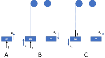

I use this diagram to simulate a system in which a person/subject is suspended in the left side and a counterweight is suspended in the right side.
243378
Figure 5
Figure 5 shows how a subject accelerates when a force is exerted on them. In 0 g (figure 5a), the force would result in an acceleration of a=f/m. In this setup (figure 5b and c), the same force would theoretically result in an acceleration a=f/2m, half the size of that in 0 g. To achieve the same acceleration as in 0 g, double the force must be applied. This is because of the added inertia of the counterweight, that also must be accelerated. The added inertia of the counterweights makes this setup dissimilar to 0 g.
The theoretical system acceleration of a=f/2m, was based on the assumption that the pulleys and ropes were massless. They are not. The added inertia of the rope and pulleys means the acceleration resulting from a force will be even lower.
The theoretical system acceleration of a=f/2m, was also based on the assumption that a force applied to the subject would be transferred through rope tension to the counterweight. This assumption was close to true, when the subject was moving downwards, resulting in increased tension in the rope and an upwards pull on the counterweight. The high inertia of the system was only felt by the subject when moving downwards.
When the subject was moving upwards, the assumption of transferred forces did not hold true. Since a rope will bend under a compressive load, the upwards force applied by to subject could not “push” the counterweight down. Because of the flexible link between them, the subject was in effect moving independently. This means that a ground reaction force accelerating the subject upwards would result in an acceleration of F=ma. This acceleration would then result in reduced rope tension, resulting in less upwards pull on the counterweight, resulting in a downwards acceleration of the counterweight.

Not true. If you double the force, the equations become
##-ma=mg+T-2F##
##ma=T-mg##
Subtract top equation from bottom
##2ma=2F-2mg~\rightarrow~a=\frac{F}{m}-g##
Clearly, the acceleration is zero when ##F=mg## for the mass on which the force is applied. That's another way of saying that the mass is weightless. Of course the other mass will be in free fall when that happens.
It is true that you cannot "push" with a rope but you need to be careful here. If ##F## is pushing "up" on the subject mass, the rope may still be under tension because of the other mass. As argued above, when the upward ##F## becomes equal to the weight, the subject mass will be moving up with constant velocity and the other mass will be in free fall; if the upward ##F## is greater than the weight, the subject mass will accelerate up and the other mass will still be in free fall. In other words, when the rope is no longer under tension (##F \geq mg##), the masses are decoupled from one another and they will each do their own thing under the influence of whatever net force is acting on them.
