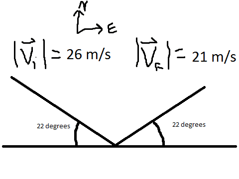

Problem: A hockey puck rebounds from a board as shown in figure 16. The puck is in contact with the board for 2.5 ms. Determine the average acceleration of the puck over the interval.
t = 0.0025 s |vi|= 26 m/s |vf| = 21 m/s aav = ? *v and a are vectors*
I have made several attempts to solve this question and have seen the previous thread about this question and I am still unable to get the correct answer. The correct answer is
7.3 x 10^3 m/s^2[7.5 N of W]. In my opinion my closest attempt was that I broke the initial vector and final vector into components, found the change in vx to equal 4.6 m/s and the change in vy to equal -1.9 and then found the change in v to equal 5. my final answer and direction were completely wrong. Can someone help me with this awful question?

These were my calculations:
|Vx| = |Vfx| + (-|Vix|)
= 21 m/s(sin68) - 26 m/s(cos22)
= -4.6 m/2 oops, i got -4.6 but on the next page i left out the negative, not sure if that is the real problem though
|Vy| = |Vfy| + (-|Viy|)
= 21 m/s(cos68) - 26 m/s(sin22)
= -1.9
|V| = sqrt((-1.9)^2 + (-4.6)^2)
= 5.0 m/s
|aav| = 5/0.0025 != 7.3 x 10^3

One of your two components of Δv is wrong here. I'll reiterate my point from post #3. Is the puck going in the same direction (along the east-west axis) after the rebound? What about along the north-south axis? Same direction as before, or opposite?
so what the problem is is that for the x components the should both be positive and for the y components it is a subtraction?
There's another problem as well. Don't compute the final acceleration from the magnitude of the velocity. Remember, acceleration is a VECTOR. So you should calculate the individual components of a first, and then combine them:
ax = Δvx/Δt
ay = Δvy/Δt
a = (ax2 + ay2)1/2

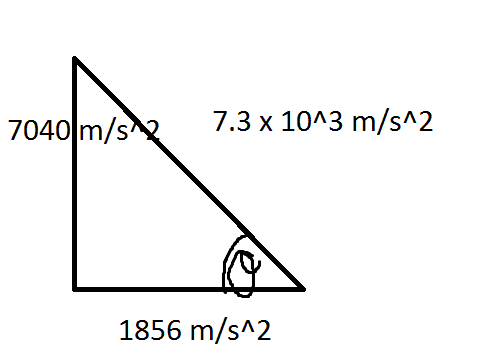

Ok, so I found the average acceleration to be 7.3 x 10^3 however, the direction I got was 75degrees N of W. Here's what I did:
|Vx| = 21 m/s(cos22) - 26 m/s(cos22)
= -4.64 m/s
|Vy| = 21 m/s(sin22) + 26 m/s(sin22)
= 17.6 m/s
aav,x = -4.64/0.0025 = -1856 m/s^2
aav,y = 17.6/0.0025 = 7040 m/s^2
Then, aav = sqrt(7040^2 + (-1856)^2) = 7.3 x 10^3
for the direction I found theta in the pic I attached and it ended up being 75NofW instead of 7.5NofW
7.5 degrees N of W must be a misprint. 75 is right. It must be fairly close to perpendicular to the wall.
