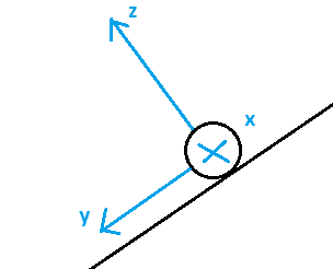

Hmm... so I decided to try writing down equations using this coordinate system:
(The x-axis is positive into the page.)
Σ ⃗Fz = (Fn) - (Fg)cos(θ) = m(v2/r)
Σ ⃗Fy = (Fg)sin(θ) + (y component of friction if there is any) = m*(ay)
Σ ⃗Fx = (x component of friction if there is any) = m*(ax)
Is that right? And then the radius r would be determined by the shape of the funnel surface.
And I think we wouldn't need to consider energy gains from gravitational potential since it's already accounted for by including the force of gravity.
I'm not sure how to solve these equations without using a computer simulation. I'm also not sure how to handle a case where there is friction... oh wait! I can just use the negative of the velocity unit vector right?

Sorry, that was misleading. I was right to say that the centripetal acceleration lies in the plane containing its velocity and acceleration vectors, but it will not in general be perpendicular to the surface. It will be perpendicular to the velocity vector.
No, as noted above.
Yes, but you have to be careful to consider the curvature in the plane of motion.
Yes, but you could only represent something like a cubic particle, i.e. one that cannot roll. Otherwise, as soon as there is friction, you have the moment of inertia of the rolling particle to worry about.
