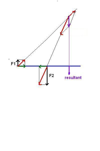

You can understand this by looking at the picture. It is a rigid rod and two forces act on it at different points, F1 and F2, parallel and of opposite direction, like in the problem Fs an -mg.
You can add two equal and opposite horizontal forces (the green ones): They would cancel, so do not influence the system of forces. Add the horizontal forces to the vertical ones: You get two forces (red) which are not parallel any more, they can be shifted to a common point where the resultant can be drawn. This resultant force can be shifted againso its point of attack is on the rod.

That picture does help, thanks.
