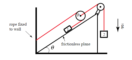

In summary, the block 1 of m1 sheets of mass on an inclined plane without friction at an angle θ to the horizontal. One end of a non-extendable rope with no mass is attached to lock 1. The chain is wound around a non-frictionally mobile pulley P of negligible mass and is also connected to the wall at the base of the inclined plane. Pulley P is connected for a second no-mass non-stretchable cord to block 2 of m2 of mass through a second, frictionless pulley that is secured in place. Block 2 hovers over the end of the inclined plane (see figure). The gravitational acceleration downwards is g.

The block 1 of m1 sheets of mass on an inclined plane without friction at an angle θ to the horizontal. One end of a non-extendable rope with no mass is attached to lock 1. The chain is wound around a non-frictionally mobile pulley P of negligible mass and is also connected to the wall at the base of the inclined plane. Pulley P is connected for a second no-mass non-stretchable cord to block 2 of m2 of mass through a second, frictionless pulley that is secured in place. Block 2 hovers over the end of the inclined plane (see figure). The gravitational acceleration downwards is g.
What is the acceleration modulus of block 2 after the system is released from rest? Suppose that m2 is large enough that it is moving down. Express your answer in terms of theta for θ, m1, m2, and g.
A2 =?
Attempted to perform with equation4 * ((4 m_2- m_1 * * (cos (theta) + sin (theta))) / (4 * + m_1 m_2)) * G
But it shows an error trying to rearrange the formula, but I can not do it right
Can you help please?
I think we may need a picture, or at the very least a description where blocks don't become locks and ropes become chains and pulleys are apparently mobile but nevertheless attached to walls.
Ah. Yes, that is much more clear.
Note that the motion of box 1 must be twice the motion of box 2. That includes displacement, speed, and acceleration.
The sum of the forces on box 2 give the acceleration of box 2
m2 g - T2 = m2 a2
Where T2 is the tension in the top rope. The sum of the forces on box 1 give the acceleration of box 1
T1-m1 g sin(Q) = m1 a1
As I noted above
a1 = 2 a2
Also from the pulley
T2 = 2 T1
Substituting for T1 and a1 the second equation becomes
T2 / 2 - m1 g sin (Q) = m1 2 a2
Now use the first equation to eliminate T2
(m2 g - m2 a2) / 2 -m1 g sin(Q) = m1 2 a2
Solve for a2 and simplify. QED
