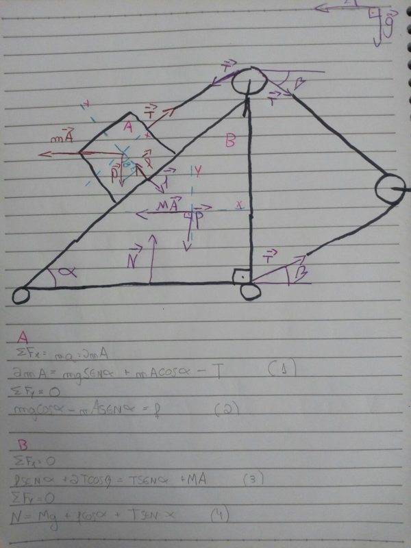

In the figure, the masses m of the box and M of the wedge, as well as the angles A and B, are all known. All wires are ideal and friction is negligible. It is necessary to determine the acceleration acquired by the wedge. Gravity is equal to g
## F = ma##
When the box travels a ## X## distance, the wedge travels ## \frac{X}{2}##. So ##a = 2A##
Using the wedge as a non inertial frame:
I didn't use (4). Using (2) on (3) and then on (1) I got:
##2mA=mgsin\alpha +mAcos\alpha + \frac{-mgcos\alpha sin\alpha +mAsin^2\alpha +MA}{2cos\beta - sin\alpha}##
##4mAcos\beta - 2mAsin\alpha = 2mgsin\alpha cos\beta - mgsin^2\alpha +2mAcos\alpha cos\beta - 2mAcos\alpha sin\alpha - mgcos\alpha sin\alpha + mAsin^2\alpha +MA##
But I can't continue. The expression is monstrous and I don't know where to start the FactorizationThe answer: ##A = \frac{2mgsin\alpha cos\beta}{M+msin^2\alpha+m(2cos\beta -cos\alpha)^2}##

Why? Say the block travels distance ##ds## down the incline. This means that the string from the mass ##m## to the pulley gets longer by ##ds##. How far does the block travel in the negative x-direction relative to the wedge? The string on the right side of the wedge gets shorter by the same amount ##ds##. How far does the wedge travel in the x-direction relative to the floor? How far does the block travel relative to the floor?

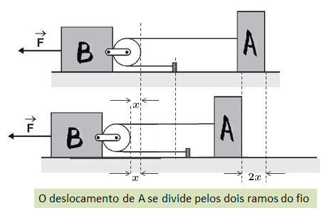

I don't know the name in english. Geometric link?
As the wires are inextensible, using the "geometric link" we can relate the accelerations. In this image's case when A travels D, then B travels D/2. Because both wire travels D/2 + D/2 = D. Inextensible.
In the wedge case, when the box travels D, the the wires travels D/2. But now that I'm looking at, i think ##a = 2Acos\beta##. In any case I'm not sure

The trick with the kinematics aspect of such questions is to think about components of motion in the directions of the strings.
E.g. look at where the string attaches to the bottom right of the wedge. If the wedge has acceleration A to the right, what is the component of that in the direction of the string attaching there? What does that tell you about how the length of that section of string changes (assuming we are starting from rest)?
Consider the changes in the lengths of the other sections in the same way and combine.

Are these equations correct?
For the block:
x -> ## 2mAcos\beta = mgsin\alpha + mAcos\alpha - T## (1)
y -> ##mgcos\alpha - mAsin\alpha = f## (2)
Wedge
x -> ##fsin\alpha + Tcos\beta = MA## (3)
When I try to solve I get ##A = \frac{mgsin\alpha (cos\alpha + cos\beta)}{M+msin^2\alpha+m(2cos^2\beta-cos\beta cos\alpha)}##
For the block:
Wedge
Your forces on the wedge are incomplete. Think about the pulley.

I confirm your equation for the tangential component of the force balance on the block. But, instead of writing a separate force balance on the wedge, write down the horizontal force balance for the combination of wedge and block (including the accelerations of both). The only external horizontal force acting on this combination is ##2T\cos{\beta}##.

The horizontal acceleration of m is not A. It is ##A-2A\cos{\beta}\cos{\alpha}##

The last equation does not follow from the equation before it. Note that
##m(2cos\beta - cos\alpha)^2 = 4mcos^2\beta -##4##mcos\alpha cos\beta +mcos^2\alpha ##
@Chestermiller is pointing out that there is an error in your equation (2) where you treated both masses as having the same horizontal acceleration ##A##.
But that is on a inertial reference frame right? If yes, then my equation 1 is wrong.
I'm trying to solve on the wedge reference of frame, that's why A is perpendicular to g, as show on the upper right corner. But now I'm stuck again
[/QUOTE]
If I want to stick to the non inertial frame then I can't use block+wedge system, I'll try on Earth's reference
I don't understand how to balance the forces of block and wedge while they have diferent horizontal accelerations.
m is ##A - 2Acos\beta cos\alpha##
M is ##A##
If you write separate force balance equations on the block and wedge, and then add the two equations together, all the internal forces cancel out, and you are left with: $$2T\cos{\beta}=MA+m(A-2A\cos{\beta}\cos{\alpha})$$

You can stick to the non-inertial frame and still set up the equation for the block+wedge system. You just need to be sure to include the fictitious forces as external forces acting on the system.
For the inertial frame, @Chestermiller has given the equation for the system:
For the non-inertial frame, you get an equivalent equation where the ##MA## and ##mA## terms appear on the left side as fictitious forces instead of on the right side.
Likes Yalanhar
For the block
##m(A-2Acos\beta cos\alpha) = Tcos\alpha - fsen\alpha)## (1)
For the wedge
##MA = 2Tcos\beta +fsen\alpha -Tcos\alpha## (2)
(2) + (1)
##MA + m(A-2Acos\beta cos\alpha) = 2Tcos\beta## (3)
Using non inertial frame, and the force balance of the block on tangente
##2mAcos\beta = mgsen\alpha + mAcos\alpha - T## (4)
(3) in (4):
##2mAcos\beta = mgsen\alpha - mAcos\alpha - \frac{MA+mA-2mAcos\beta cos\alpha}{2cos\beta}##
##4mAcos^2\beta = 2mgsen\alpha cos\beta + 2mAcos\alpha cos\beta - MA - mA +2mAcos\alpha cos\beta##
##A(4mcos^2\beta - 2mAcos\alpha cos\beta + M + m - 2mAcos\alpha cos\beta) = 2mgsen\alpha cos\beta####m = m(sen^2x + cos^2x)####A(4mcos^2\beta - 4mAcos\alpha cos\beta + M + msen^2\alpha + mcos^2\beta) = 2mgsen\alpha cos\beta##
##A[m(2cos\beta - cos\alpha)^2 +M +msen^2\alpha] = 2mgsen\alpha cos\beta##
##A = \frac{2mgsen\alpha cos\beta}{[m(2cos\beta - cos\alpha)^2 +M +msen^2\alpha]}##I think it's all sorted out.
