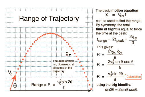

Here's some slides with projectile motion and graphs for your t-shirt (just add a pumpkin somewhere):
http://hydrogen.physik.uni-wuppertal.de/hyperphysics/hyperphysics/hbase/traj.html
