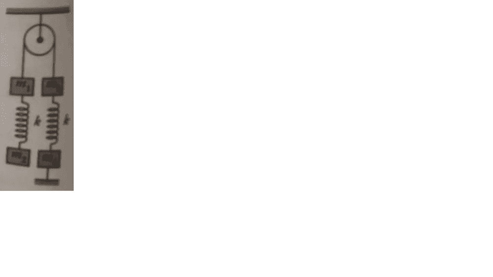

The diagram given below.
Find the acceleration of each mass when the string connecting ##m_4## to the ground is cut.
You can assume that the system is at equilibrium before the string is cut, the string is massless and inextensible, the springs are massless, the pulley is smooth and massless.
Newton 2nd law
m1 = top left
m2 = bottom left
m3 = top right
m4 = bottom right
My questions:
1. Will all the object (m1, m2, m3,and m4) have same acceleration?
2. Should I assume initial extension of both spring is the same? (only based on the picture)
3. Will the extension of the spring change after the string is cut?
Thanks

I have tried to draw free body diagram for each object when they are in equilibrium.
For m1, there are tension upwards, weight downwards and spring force downwards
For m2, there are tension upwards and weight downwards
For m3, there are tension upwards, weight downwards and spring force downwards
For m4, there are tension downwards, weight downwards and spring force upwards
After the string is cut, I tried to set up equation of Newton 2nd law but not sure about all the things I asked in post#1
I do not know whether the acceleration of all the masses will be the same or not. Maybe the acceleration can be the same because they all move as one system but I also think the acceleration can be different if somehow the extension of the spring changes during the motion, so I can't proceed.
How to know whether the extension will change or not during the motion?
Thanks

ΣF1 = k.x1 + m1.g - T
m1.a1 = k.x1 + m1.g - T ...(1)
ΣF2 = m2.g- k.x1
m2.a2 = m2.g- k.x1 ... (2)
ΣF3 = T - k.x2 - m3.g
m3.a3 = T - k.x2 - m3.g ...(3)
ΣF4 = k.x2 - m4.g
m4.a4 = k.x2 - m4.g ... (4)
Then how to continue? Thanks
Count the number of unknowns to check if you miss an equation ...
And: what is ##T, x_1, ## etc ?
Do you describe equilibrium, or the situation after the wire is cut ?
Likes songoku
I have 7 unknowns (a1, a2, a3, a4, T, x1, x2) and 4 equations so I am missing 3 equations and I do not know what those 3 equations are
T = tension on string connecting m1 and pulley = tension on string connecting m3 and pulley
x1 = extension of spring connecting m1 and m2
x2 = extension of spring connecting m3 and m4
I describe the situation after the wire connecting m4 and ground is cut.
I assume at equilibrium, both spring are extended by same amount so the springs produce equal forces on all the masses (let say k.x, where x is extension of both spring when the system is in equilibrium)
After the wire is cut, I assume the extension of both springs is not the same so on left spring is x1 and right spring is x2

songoku said:
What will be the next step? What should I understand to continue? Thanks
We are only concerned with the instant after the string is cut. What will be the extensions at that time?
Likes songoku
Will be the same as initial extension of the spring when at equilibrium?
When at equilibrium, how will the extension of the spring be? I am trying to understand the direction of the restoring force. Let say I consider the spring on the right, is the extension of the spring is both upwards and downwards (I mean m4 will cause downwards extension and m3 causes upwards extension) so the restoring force on m4 will be upwards and on m3 will be downwards?
Thanks
Thanks
Extension is how much longer the spring is than when it is relaxed. There is no separate upwards and downwards. Likewise, it exerts the same pull at each end.
Likes songoku
So the extension of the spring at the instant when the wire is cut is the same as the extension of the spring when at equilibrium? I think from vela's hint there will be change in the extension, or maybe I am misinterpreting something?
Thanks
Yes. It can't change instantly.

Ok, I think I am missing one more equation. Maybe equation relating a1 to a2 or a3 to a4? Will a1 be the same as a2 because at the instant the wire is cut, m1, the left spring and m2 will move downwards as one system and also the extension of the spring has not changed?
Thanks
How so?
You know the tensions in the springs now. That leaves four accelerations (but two are the same), and the tension in the string. You have four equations. Solve.
Likes songoku

At equilibrium position:
1. for object m1
∑F = 0
T = m1.g + kx (where T = tension on string connecting m1 and pulley = tension on string connecting m3 and pulley and x is extension of the sping)
2. for object m2
∑F = 0
kx = m2.g
3. for object m3
∑F = 0
T = m3.g + kx
4. for object m4
∑F = 0
kx = m4.g + Ts (where Ts is the tension on string connecting m4 to ground)After string connecting m4 to ground is cut:
1. for object m1
∑F1 = m1 . a1
k.x + m1.g - T' = m1 . a1 → I think the magnitude of T will change after Ts is cut because if not, m1 won't have acceleration so I use T' to denote the magnitude of the tension connecting m1 and pulley when m1 is accelerating. Am I correct?
2. for object m2
∑F2 = m2 . a2
m2 . g - kx = m2 . a2 → because m2 . g = kx so a2 = 0?
3. for object m3
∑F3 = m3 . a1
T' - kx - m3.g = m3 . a1
4. for object m4
∑F4 = m4 . a4
kx - m4.g = m4 . a4
Am I correct until this part?
Counting variables is still a problem: you need to distinguish ##x_1## and ##x_2##. The picture shows both springs have the same ##k##.
"Knowns" ##\qquad m_1, m_2, m_3, m_4, k##
Unknowns ## \qquad T, T_s, x_1, x_2##
4 equations, so now the unknowns are determined. In particular ##T_s##
songoku said:
After string connecting ##m_4## to ground is cut:
Counting variables is now a big problem: You can't make do with ##x_1## and ##x_2## any more: there are 4 masses and three accelerations, so you'll need to re-think the kx
My suggestion: have four ##x## (well defined) and four ##a## and try to find 8 equations (##a_1 = -a_3 ## being one of them)
It might also help if you first do the exercise with ## m_2 = m_4 = 0 ## :nb) .

haruspex said:
Yes, but you seem to have overlooked @BvU 's advice:
Let me redo:
1. for object m1
∑F = 0
T = m1.g + kx1 ...(i) (where T = tension on string connecting m1 and pulley = tension on string connecting m3 and pulley and x is extension of the left sping)
2. for object m2
∑F = 0
kx1 = m2.g ... (ii)
3. for object m3
∑F = 0
T = m3.g + kx2...(iii) (where x2 is the extension of the right spring)
4. for object m4
∑F = 0
kx2 = m4.g + Ts ...(iv) (where Ts is the tension on string connecting m4 to ground)
From (i) and (ii): T = m1.g + m2.g ...(v)
From (v) and (iii):
m1.g + m2.g = m3.g + kx2
kx2 = m1.g + m2.g - m3.g ... (vi)After string connecting m4 to ground is cut:
1. for object m1
∑F1 = m1 . a1
k.x1 + m1.g - T' = m1 . a1, where T' is the tension of string after Ts is cut
m2.g + m1.g - T' = m1 . a1
T' = m2.g + m1.g - m1 . a1 ... (vii)
2. for object m2
∑F2 = m2 . a2
m2 . g - kx1 = m2 . a2
a2 = 0
3. for object m3
∑F3 = m3 . a1
T' - kx2 - m3.g = m3 . a1 ... (viii)
From (vi), (vii) and (viii):
m2.g + m1.g - m1 . a1 - m1.g - m2.g + m3.g - m3.g = m3 . a1
a1 = 0?
Thanks
songoku said:
Let me redo:
1. for object m1
∑F = 0
2. for object m2
∑F = 0
kx1 = m2.g ... (ii)
3. for object m3
∑F = 0
4. for object m4
∑F = 0
From (v) and (iii):
1. for object m1
∑F1 = m1 . a1
2. for object m2
∑F2 = m2 . a2
a2 = 0
3. for object m3
∑F3 = m3 . a1
a1 = 0?
Thanks
Right so far. What about m4's acceleration?
Likes songoku
For object m4:
k.x2 - m4.g = m4 . a4
m1.g + m2.g - m3.g - m4.g = m4. a4
a4 = (m1.g + m2.g - m3.g - m4.g) / m4
Only object 4 is accelerating, while object 1, object 2 and object 3 move with constant speed?
Thanks
songoku said:
For object m4:
Thanks
Yes, but what "constant speed"?
Likes songoku
  • #31
hhmm... I think the value of the speed will be zero because initially object 1 to 3 does not move and no acceleration means that no resultant force acting on it.
So, at the instant the wire is cut, only object 4 will move?
Thanks
  • #32
Thanks
Yes.
Likes songoku
  • #33
haruspex said:
Yes.
What if I modify the question a little bit, find the acceleration 2 seconds after the wire is cut?
This is what I have in my mind:
The m4 will push the right spring so the new extension (x3) will be less than x2 and all the other masses will move.
The extension on left spring does not change (still x1) because the left spring, m1 and m2 will move as one system so the acceleration of m1 and m2 will be the same.
This means that the left spring will behave just like an inelastic string.
The magnitude of a1, a2 and a3 will always be the same but all the acceleration, including a4 won't be constant because there is continuous change in the extension of right spring, therefore there is continuous change in restoring force and there is continuous change in resultant force.
Am I correct?
If yes, how to set up equation of m4 to account for continuous change in acceleration?
Thanks
