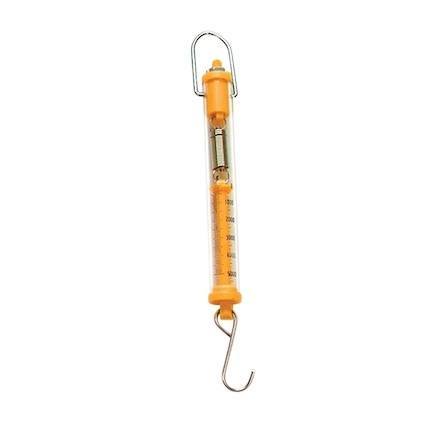

Let's stick with old-fashioned measuring apparatus. How does a dynamometer measure force?
simple calibration of the spring under tension via Hooke's law restoring force, write a scale on the side in preferred units.
In other words, the dynamometer is measuring the force necessary for the spring to counter the force due to gravity, the equivalent of ##F_\mathrm{chair}## above.
houlahound said:
the spring is not registering a force if it is unloaded but it still "feels" 1g force.
That's an arbitrary choice of the zero, since we want to measure the weight of a mass added to the spring. The spring can be slightly elongated compared to when it is at rest horizontally.
