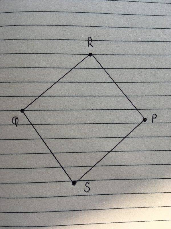

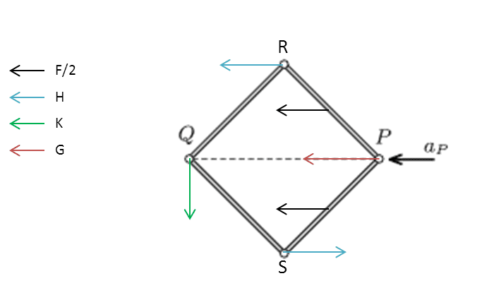

Label the other two vertices R, S.
At P, rods PR, PS are each subjected to a force F/2 towards Q. They also exert a force G normally to this on each other. Suppose that's a tension, so it acts towards the line PQ on each. Then there'll be a force parallel to PQ acting between PR and QR at R. Probably a compression - call its magnitude H. Similarly at S. Finally, a force K parallel to RS at Q between QR and QS.
Each of the four points accelerates. R and S will accelerate equally and oppositely. In terms of the accelerations aP and aR, you can write the linear and angular accelerations of rod PR. Likewise the other rods.
You can now write out the two linear and one angular force/acceleration equations for each rod. By symmetry, it's only worth doing this for, say, PR and QR. Pls try to to write those out.
Have I mentioned the forces correctly?

About what point do I need to take moments? R and S are not fixed points so I don't think I can calculate moments about those points.
In terms of your diagram, F acts to the left on the whole system, F/2 on each of PR, PS.
G acts vertically, down on PR, up on PS. This is a force that PR, PS exert on each other. By symmetry, it can only be straight up-and-down.
H acts to the left on QR, QS and to the right on PR, PS.
K acts vertically, down on QR, up on QS. This is a force that QR, QS exert on each other. By symmetry, it can only be straight up-and-down.
(Note: G and K might turn out negative.)
You're only concerned with instantaneous acceleration, so the points are effectively fixed.

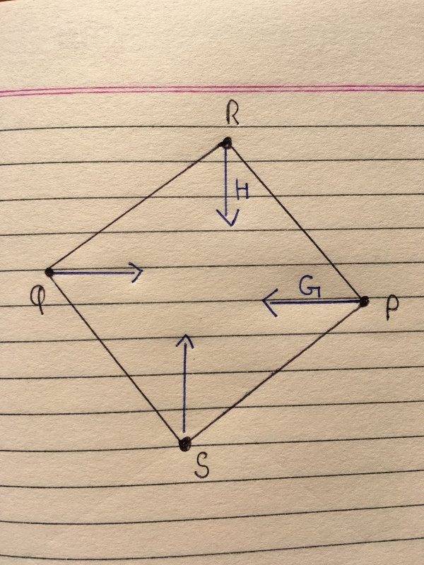

Please confirm that I have mentioned the forces correctly.
After your confirmation, I will begin making equations.
Thank you for your help so far. :)
That is indeed what I wrote, but I realize now I did make one mistake. At junctions R and S there will be a vertical force as well. It will be upwards on RQ, SP and downwards on RP, SQ. Sorry about that.

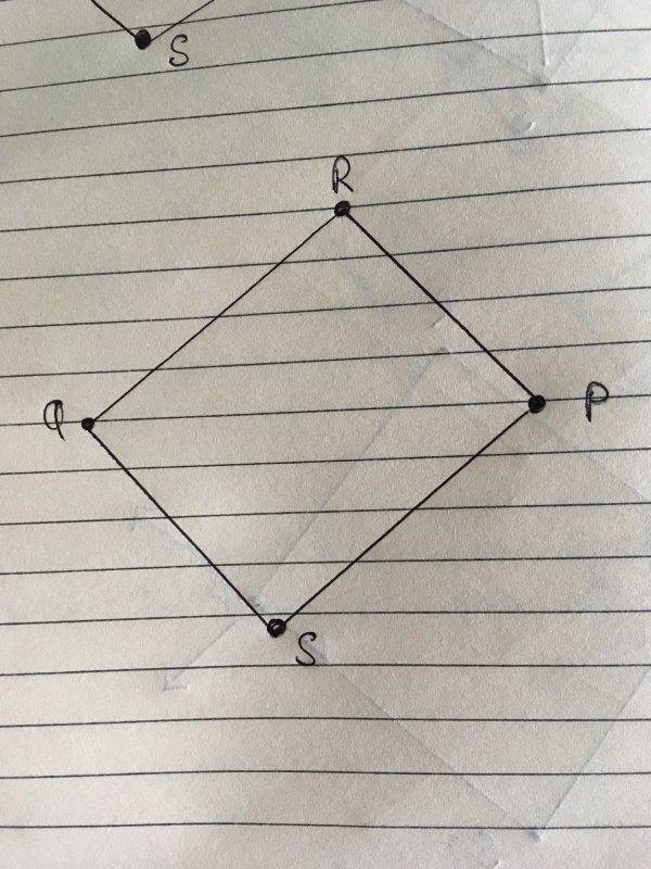

@haruspex The direction of normal forces has quite confused me (I’m in one of those states of mind, which I mentioned earlier, where I began to object every clause). Consider this diagram of our actual question:
In this wikipedia article, it is written that normal force always acts in a direction so as to restrict one object to move into the other.
If we follow the above definition for the direction of normal force, then let’s analyse the normal force on the junction ##R##. The rod PR won’t allow the rod QR to move into it, therefore, one component of normal force will be along ##\vec{RQ}##, similarly RQ won’t allow PR to move into it, therefore, the other component of the normal force will be along ##\vec{RP}##. Adding these two components will give us the result normal force at R in the direction of ##\vec{RS}##.
If I follow that same definition for the direction of normal forces, I would get this diagram:
Which is quite against what you wrote here:
Please resolve this discrepancy.
That assumes there is no linkage. In the present problem, R, as one end of PR, cannot move in any direction relative to R as one end of QR.
It may be clearer if you model the joint as a pin (normal to the page) on PR inserted in a ring on QR. the normal force between pin and ring can be in any direction.
Besides, even with the logic you gave you reached the wrong conclusion. Wrt keeping PR out of QR, the force QR exerts on PR would be in the direction QR, so the force PR exerts on QR would be in the direction RQ. Wrt keeping QR out of PR, the force PR exerts on QR would be in the direction PR. If these are of the same magnitude then the net force PR exerts on QR would be in the direction PQ, not RS.

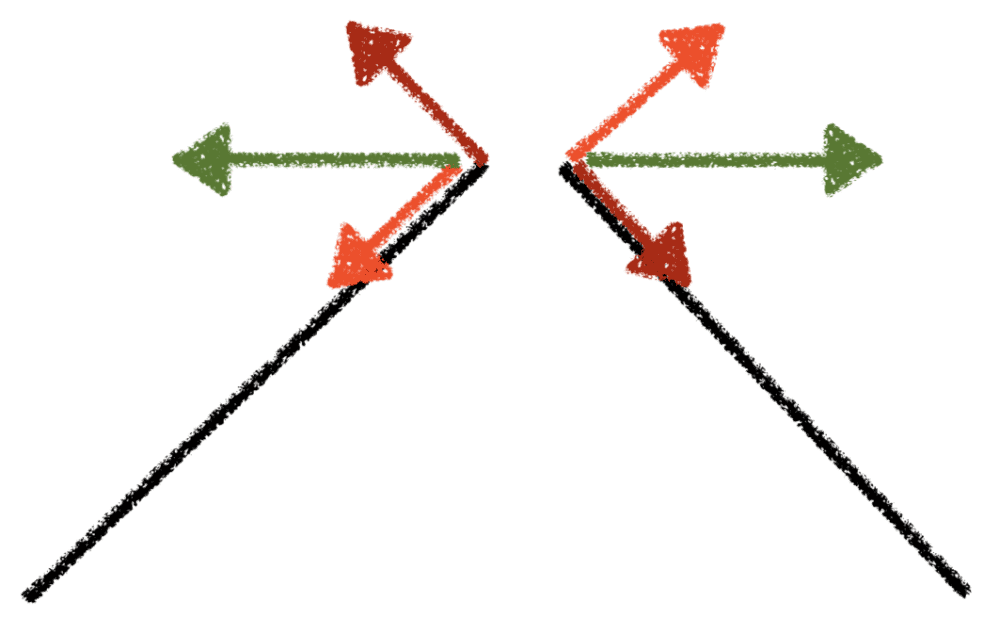

@Adesh there are two ways I like to think about joints/hinges. The first is that it's just a means of the two rods exerting a pair of contact forces on each other, which are necessarily equal and opposite. This doesn't constrain the possible directions, and I quite like @haruspex's idea of a pin inside a ring for this. Sometimes by symmetry considerations you can simplify things (i.e. eliminate the possibility of certain components), but a priori you can make no assumptions.
The second is in an engineering-style "method of joints" approach, where so long as the structure is a truss (only axial forces) in static equilibrium you can resolve forces on the joint to be zero. If the joint is accelerating, this approach no longer works since we have no idea what the "mass" of the joint is. You need to be much more careful with this method, since we have to assume the struts are massless (so that it is a two force member) for the contact forces to be parallel to the struts.
So in this problem only the first method applies, and we just end up with essentially 16 internal contact forces, 4 on each rod.

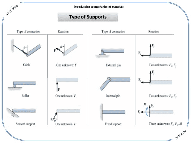

I like this set of Purdue notes; trusses and frames are treated separately. Frames are much more general and there is the possibility of shear stress in addition to axial stress on each member. Truss structures are special cases where every member is is a two force member with no shear stress.
So for any hinge in a frame, the force pairs can point in potentially any direction since there is no restriction on shear components of the contact force. The method of joints is no longer very helpful for frames, then, since its power relies on the directions of the contact forces already being known. The joint is still in equilibrium once you evaluate the forces, though.
I would say try not to think about 'preventing the two rods moving into each other', since it's impossible for me to visualise the orientation of the interface at the joint without doing some work first. All we can say with certainty is that the rods exert equal and opposite forces on each other, which could potentially be in any direction. @haruspex is an expert with infinitely more insight than I can offer, however, so I'll wait to see if he has a hot take on it!
Likes Adesh
Adesh said:
Would you please explain the above quote? I don’t think I quite got you.
In your reasoning, you added the normal force you expected PR to exert on QR to the normal force you expected QR to exert on PR. Those are not two forces acting on the same object, nor exerted by the same object, so you cannot add them to get anything meaningful.
To get two addable forces you have to turn one of them around into its equal and opposite reaction. When you do that, you discover the resultant is parallel to PQ, not RS.
Likes Adesh and etotheipi
But if I follow that rule, I’m getting the wrong direction for the force ##\mathbf G##.
Considering our usual frame : the force SP will exert on PR to keep it out is in the direction SP, therefore the force PR will exert is in the direction PS. The force that PR will exert on PS to keep it out will be in direction RP, adding those two forces (as they are exerted by the same object) we have $$\hat{PS} + \hat{RP}= \hat{RS}$$ But according to the diagram in post #9 (to which you have certified) my conclusion about G is wrong.
  • #32
Here are the two rods, hinge not shown. The two pairs of contact forces are as shown in red/orange, and their resultants in green. Note that the red and orange components are not necessarily of equal magnitude! Any combination of magnitudes is initially possible. Though in the case that both components happen to have the same magnitudes, the resultants are indeed horizontal if the rods are initially at 45 degrees.
  • Love
Likes Adesh
  • #33
I really admire your artistic work :)
I was talking about the rods PR and SP. Please draw the diagrams for them, it’s a request.
  • Love
Likes etotheipi

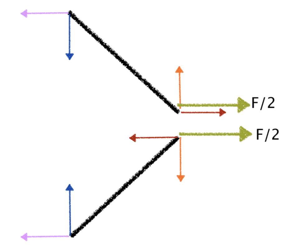

  • #34
Here's what I would do. On each I've shown the external forces of F/2, and the internal forces as smaller arrows.
The red ##x## components have to be zero because of top/bottom symmetry. I.e. we can't favour any particular side to have the forward force and the other to have the backward force, so they both have to be zero.
Similarly, we know that the blue and purple forces on the top rod will be the same as the blue and purple forces on the bottom rod, again but symmetry. But the magnitude of the blue doesn't necessarily equal that of the purple.
From then on, you can start writing down equations to try and figure out what some of them are!
  • #35
By the way, if we keep pulling the frame with constant force F then it will behave like the mathematical pendulum. The angle ##\alpha## from the paper satisfies the mathematical pendulum equation. Even asymptotic solutions will be present.
