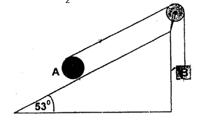

Sphere A of mass 2 kg is connected to object B (4 kg) through a pulley (0.5 kg). If sphere A rolls without slipping, find the acceleration of the system.
(Radius of pulley = 20 cm)
Στ = I . α
ΣF = m.a
There is no friction mentioned by the question so I assume the plane is frictionless but can the sphere roll without slipping if there is no friction?
This is my attempt:
Equation of translation motion of object A (assuming A moves upwards):
TA - WA sin θ = mA . aCOM (A)
TA = mA . aCOM (A) + WA sin θ ...(1)
Equation of rotational motion of object A:
TA . R = ##\frac{2}{5}## mAR2 . ##\frac{a_{tangential(A)}}{R}##
TA = ##\frac{2}{5}## mA . atangential (A) ...(2)
Since A rolls without slipping → aCOM (A) = atangential (A)
Equating (1) and (2), I get aCOM (A) = - 13 ms-2 → is this value possible? bigger than acceleration of free fall?
So this means sphere A rolls downwards, but the acceleration of the point of contact between the sphere and inclined plane (let say point X) is not zero so the sphere is not rolling without slipping with respect to point X. Does this mean the question refers the motion of rolling without slipping actually with respect to the point where the tension acts on the sphere / top part of the sphere (let say point Y)?
But the acceleration of point Y on sphere A should be the same as the acceleration of the center of mass of object B so the acceleration of B is zero?
I am really confused. Where is my mistake?
And by "acceleration of system", what does the question refer to? Is it acceleration of center of mass of A or of B?
Thanks
EDIT: or maybe actually this question is about static condition? None is moving?

It’s worth noting that the radius of sphere A is not supplied. (From the diagram, it's not the same as the radius of the pulley.) This creates problems.
I also struggle to understand how the string is attached to the sphere. Is the end of the string fixed to the top of the sphere? Or is the string wound around the sphere?
(And whoever drew the diagram had no idea what an angle of 53º looks like.)
Nice catch with the sphere radius. I assume it's just been left out of the post.
I assume its wrapped around, since it rolls without slipping. If it were pinned to the top, I think there would be some problems with that condition (and much more missing information)?

This is what I did:
Equation of translation of A:
TA + f - WA sin θ = mA . aCOM (A) (where f is the friction) ... (1)
Equation of rotational motion of A:
TA . r - f . r = IA . αA ... (2)
Equation of rotational motion of pulley:
TB . R - TA . R = Ipulley . αpulley ...(3)
Equation of B:
WB - TB = mB . aCOM (B) ... (4)
Equation relating aCOM (A) and aCOM (B):
aCOM (B) = 2 aCOM (A) ... (5)
There are 5 equations and 5 unknowns (TA , TB , f , aCOM (A) and aCOM (B)) so I am able to solve it.

That all looks fine, except that I see no equation relating ##\alpha_{pulley}## to other accelerations, and the OP does not give the radius of the sphere.
Likes songoku
αA = aCOM (A) / r
αpulley = aCOM (B) / R

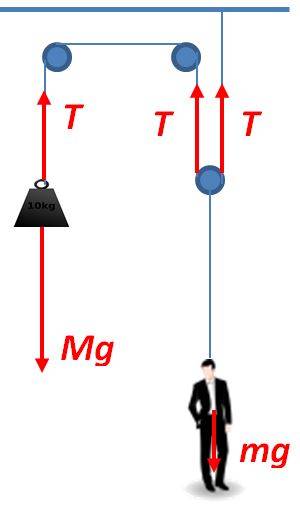

I understand it as essentially similar to the system shown in the attached picture, but considering the rotational inertia of the fixed pulley and the rolling sphere (a second pulley, if you wish).

Please forgive me for going off-topic but the image in @Lnewqban ’s Post #29
https://www.physicsforums.com/attachments/manlift-jpg.305490/

  • #32
Thank you, @kuruman.
I would pick items 1 and 3, because those are the only ones having linear accelerations (here assuming that that is the type of acceleration requested to be calculated by the problem).
Item 5 must be considered as well because it determines the fraction of the weight of item 1 that is resisting the weight of item 3 (driving force in the system), or tension in item 4.
The rotational inertia of items 1 and 2 also resist the effect of the driving force; therefore, both need to be considered.
  • #33
You originally proposed taking the vector sum of the two accelerations, which is bizarre.
In post #23, you mention COM, so you might be proposing the acceleration of the mass centre of the system consisting of the two linearly moving masses. If so, @kuruman already offered that in post #17, and I agreed that was defensible.
But I could also interpret your post as meaning the weighted average of the magnitudes of the two linear accelerations, which also has some validity. That interpretation seems to be supported by posts #29 and #32.
But the whole discussion is fruitless. The question does not define "the system" (why exclude the massive pulley?), it does not mention magnitudes and does not mention COM. If we're playing guess the question setter's intent, it is clear s/he overlooked the ambiguity, so may well have just been thinking of the descending mass.
@songoku has solved the problem as far as is possible.
Likes erobz
