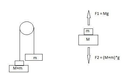

Find the acceleration of the block on the left in terms of M, m and g.
See attachment
F=ma
From the free body diagram,
-Mg+Mg+mg=(m+M)*a
a=m*g/(m+M)
I think this is correct, however the solution states the correct answer as
a=m*g/(m+2M), indicating a problem with the signs.
While finding the acceleration of the masses, you have to take into account the tension in the string.
(M +m)g - T = (M+m)a...(1)
T - mg = ma. ...(2)
Now solve for a.
