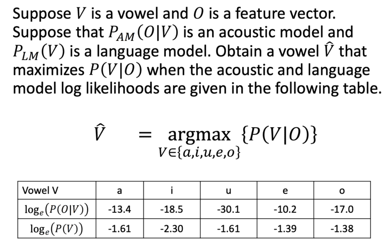

Suppose 𝑉 is a vowel and 𝑂 is a feature vector.
Suppose that 𝑃 AM (𝑂|𝑉) is an acoustic model and 𝑃 𝐿M (𝑉) is a language model. Obtain a vowel 𝑉 that maximizes 𝑃(𝑉|𝑂) when the acoustic and language model log likelihoods are given in the following table.
W: a vowel v (v ∊ {a,i,u,e,o})
O: a feature vector
Question:

What role do the numbers in the log table play?

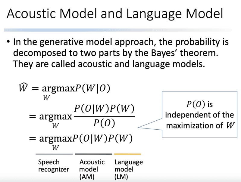

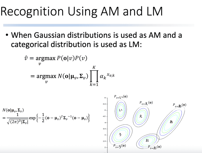

This is the reference that I got, I don t know about what argmax mean here, so I assumed it has the same meaning as log e (P(V|O)).
