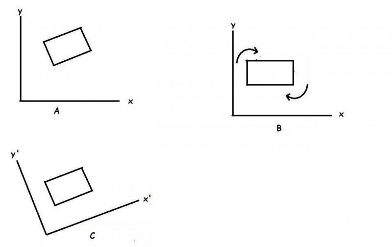

Hi all,
I'm sort of struggling to understand the difference between active and passive transformations. I'm working with two books, and both say that in one case the vectors are transformed (active) and in the other the operators are transformed (passive). That's fine and dandy, but in terms of being able to actually identify a transformation as one or the other, I am at a loss.
For example, in Boas's Mathematical Methods in the Physical Sciences, she uses two 2x2 rotation matrices as examples. The first has a -sinΘ in the upper right and the sinΘ in the lower left, and is the vector rotation, and the second is the same but with sine terms swapped, and is claimed to be "axes" rotated.
Now, if you just switch the direction of rotation, one effectively becomes the other... i.e., change the sign of Θ and suddenly you have the other matrix. So what make one passive and the other active, really?

This terminology confuses the hell out of me too, but I think I understand the following at least. Let R be a rotation operator on ##\mathbb R^3##.
The active transformation by R of a vector x is the map ##x\mapsto x'=Rx##. Note that we have
$$x_i=(Rx)_i =R_{ij}x_j.$$ The passive transformation by R of the vector x is the map ##x\mapsto x'## induced by the transformation ##e_i\mapsto e_i'=Re_i## and the equalities ##x=x_ie_i=x'_ie'_i##. We have
$$x_je_j=x'_i e'_i =x'_i Re_i=x'_i (Re_i)_j e_j =x'_i R_{ji} e_j =x'_i (R^{-1})_{ij} e_j.$$ People never seem to understand the third equality above, so I'll explain it: I'm just rewriting ##Re_i## as a linear combination of basis vectors. The fourth equality requires you to understand the relationship between linear operators and matrices. (If you don't, see the https://www.physicsforums.com/showthread.php?t=694922 about it).
The above implies that ##x_j=x'_i (R^{-1})_{ij}##. Multiply this by ##R_{jk}##. We get
$$x_j R_{jk}=x'_i (R^{-1})_{ij}R_{jk} =x'_i (R^{-1}R)_{ik} =x'_i \delta_{ik}=x'_k.$$ So
$$x'_i=x_j R_{ji}=(R^{-1})_{ij}x_j =(R^{-1}x)_i,$$ i.e. ##x'=R^{-1}x##.
So a passive transformation by ##R## of x is an active transformation by ##R^{-1}## of x.
If we view x not as the vector, but as the vector's matrix of components with respect to the ordered basis ##(e_1,e_2,e_3)##, then we can describe the above as follows: An active transformation by R acts on each vector's matrix of components. A passive transformation by R acts on the basis vectors.
It's also useful to think about this in physical terms. Suppose that R is a clockwise rotation by 30°. Then you can think of the active transformation by R as a clockwise rotation by 30° of the object on which you intend to do a measurement, and a passive transformation by R as a counterclockwise rotation by 30° of the measuring device (or the entire laboratory, or the entire universe...except for the object on which you intend to do a measurement of course).

Active versus passive transformation for vectors has to do with changing vectors versus changing coordinates. If you are moving East, and you turn counterclockwise through 90 degrees, then you'll be heading North. That's a different velocity vector than the one you started with. But now look at your journey on a map. Hold the map one way, and you're traveling horizontally across the map. Turn the map clockwise through 90 degrees, and now you're traveling vertically across the map. Your velocity hasn't changed, but its representation in terms of horizontal and vertical has changed.
Mathematically, an active change of a vector means an operation that takes a vector and returns a different vector. A passive change leaves the vector alone, but changes the basis that you use to describe that vector.
So if [itex]v[/itex] is a vector, and [itex]R[/itex] is a rotation, a linear transformation on vectors, then [itex]R(v)[/itex] is a new vector, call it [itex]\tilde{v}[/itex],different from [itex]v[/itex]. In terms of components, let [itex]v^i[/itex] be the components of [itex]v[/itex], so
[itex]v = v^i e_i[/itex], where [itex]e_i[/itex] is the [itex]i^{th}[/itex] basis vector, and where by convention, repeated indices are summed over. Let [itex]\tilde{v}^i[/itex], be the components of [itex]\tilde{v}[/itex]. Since [itex]R[/itex] is a linear transformation, we can write:
[itex]\tilde{v}^i = R^i_j v^j[/itex] (again, [itex]j[/itex] is summed over)
So,
[itex]\tilde{v} = \tilde{v}^i e_i = R^i_j v^j e_i[/itex]
Now, we can define a new basis, [itex]\tilde{e}_j[/itex] via: [itex]\tilde{e}_j = R^i_j e_i[/itex]. So we can also write:
[itex]\tilde{v} = v^j \tilde{e}_j[/itex]
So there are two ways to represent the rotated vector [itex]\tilde{v}[/itex] in terms of components:
  1. Keep the basis [itex]e_i[/itex] and rotate the components, [itex]\tilde{v}^i = R^i_j v^j[/itex]
  2. Keep the components [itex]v^i[/itex] and rotate the basis, [itex]\tilde{e}_i = R^j_i e_j[/itex]
These are both active transformations--they are changing the vector [itex]v[/itex] to a different vector, [itex]\tilde{v}[/itex]. Now, let's use [itex]\tilde{v}[/itex] in the form [itex]\tilde{v}^i e_i[/itex] and rotate back using the inverse transformation [itex]R^{-1}[/itex]. Again, we have the option of writing [itex]R^{-1}(\tilde{v})[/itex] by keeping the components the same, [itex]\tilde{v}^i[/itex] and rotating the basis, or the other way around. Let's keep the components the same. So we have:
[itex]v = R^{-1}(\tilde{v}) = \tilde{v}^i (R^{-1})^j_i e_j[/itex]
So we have:
[itex]\tilde{v} = \tilde{v}^i e_i[/itex]
[itex]v = \tilde{v}^i (R^{-1})^j_i e_j[/itex]
So using the tranformed coordinates [itex]\tilde{v}^i[/itex] might mean two different things:
  1. We might be talking about the vector [itex]\tilde{v}[/itex] in the original basis, [itex]e_i[/itex]. That's an active transformation.
  2. We might be talking about the vector [itex]v[/itex] in the counter-rotated basis, [itex](R^{-1})^i_j e_i[/itex]. That's a passive transformation.
