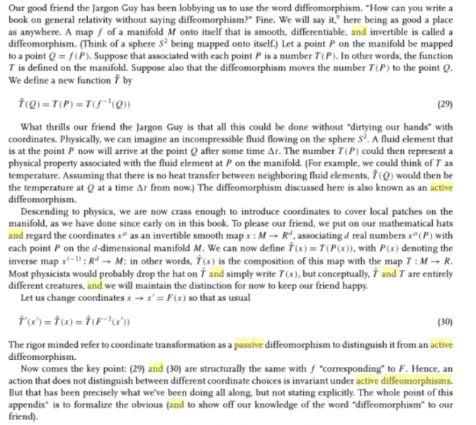

I found in the attachment an explication (from A. Zee, Einstein Gravity in a Nutshell) which, while very similar to Rovelli’s, looks to me much more clear (beside the statement “Suppose also that the diffeomorphism moves the number T(P) to the point Q” (what does that mean?)).
I would like your comment if you also find that part of Rovelli’s book confusing (or it is just me!) and if you can help me mapping the symbols between Rovelli's and Zen's texts.
Ouch, if this is more clear than Rovelli, then I think I'd rather not look at Rovelli.
That statement doesn't mean anything, but the comment about the fluid makes it possible to guess what he was thinking. f(P)=Q is where the piece of the fluid that's currently at P will be a time Δt from now. T(P) is the temperature of the piece of fluid that's located at P right now. T(Q) is the temperature of the piece of fluid that's located at Q right now. ##\tilde T(Q)## is the temperature of the piece of fluid that will be at Q a time Δt from now. That's the piece that's currently at ##P##. So we have ##\tilde T(f(P))=T(P)## for all points ##P##. If ##T## and ##\tilde T## are coordinate systems, then ##\tilde T## is the coordinate system that assigns the old coordinates to the new points.
Likes albedo
Yes, I see what you mean. Thank you for having basically re-worked all Zen’s explication! I also understand that statement as you describe. The fluid example he gives is also similar to the Rovelli’s “wind and temperature” notions when Rovelli introduces the concepts at p. 62 of the book.
What I meant by “more clear” when comparing to Rovelli's (hoping I am not misleading myself!) is that I found more satisfactory the Zen’s notation when comparing his equations 29 and 30:
##\tilde T(Q)=T(P)=T(f^{-1}(Q))##
##\hat T’(x’)=\hat T(x)=\hat T(F^{-1}(x’))##
First, I liked he used different symbols for the different maps ##f: \mathbb M\rightarrow\mathbb M ## and ##F: \mathbb R^d\rightarrow\mathbb R^d## as the domains are different. Second, I like making the intuitive correspondences between points when working in the manifold and points when working in ##R^d## i.e. point P corresponding to x, transformed point Q corresponding to transformed coordinate x’.
I would have liked Rovelli following a similar notation which is, btw, recovered from Zen's when you put ##t=\hat T##, ##t’=\hat T’##, ##\phi=f^{-1}=F^{-1}##. For some reason, I arrive in this case to follow better the formalism from Zen than the one from Rovelli, go figure out why ... :-)
