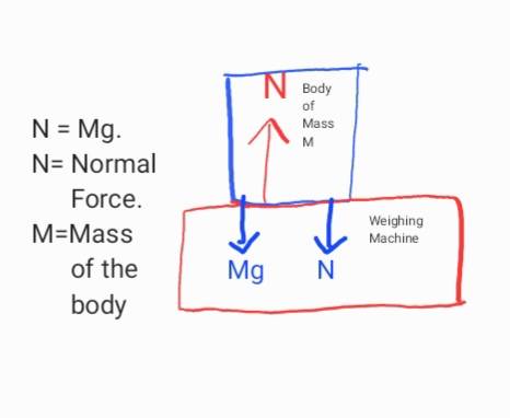

How ever, What is N here? Can you draw a free body diagram and show every force that acts on the machine?
Note that you should only draw forces that acts on machine.
See the picture. 3 forces act on machine. Can you identify them?
These are the forces acting on it according to me

Draw a free body diagram (I'll bet someone has told you that before !!!...... so where is it?). Your prof did not suggest this because she wants to teach you art.
This is a rough FBD that I drew . Can you explain as to why mg isn't added to the final weight along with normal?

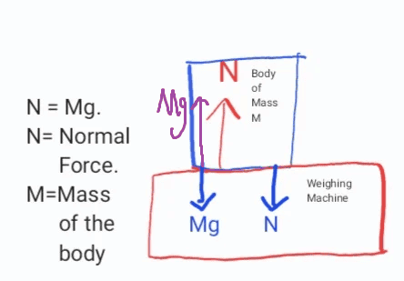

Physicsnb said:
If body pushes machine down with force ##Mg## then machine pushes the object up with force ##Mg##.
So 3 forces act on body.
##N## and ##Mg## upward.
##Mg## downward.
As you see the net force cannot be 0 and the body should accelerate upward!
So that ##Mg## does not act on machine in my opinion. And please wait for @hutchphd and @Steve4Physics ideas. They will help more than me.

Physicsnb said:
This is not a free body diagram. A free body diagram isolates a part of the system and draws all of the forces acting on that part. This is not what you have drawn here.
Generally you seem to be confusing yourself. The gravitational force acts on the mass, not on the machine. The only force between body and machine is the contact (normal) force. The gravitational force acts on the body.

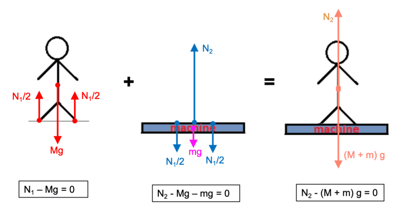

@Physicsnb, if you are still reading this thread, see if this helps.
We have:
- a body resting n a weighing machine (‘the machine’);
- the machine (say of negligible weight) resting on the earth.
Here are three free body diagrams – for the body, for the machine and for the earth. Forces always occur in (Newton 3rd law) pairs. Each pair is colour-coded in the diagrams. All the relevant forces are shown. I recommend studying the diagrams thoroughly!
I disagree with the middle FBD. The machine itself has some mass and is attracted by the Earth, so there must be 3 forces acting on it. See post #2 by @MatinSAR.
That's why I specifically said (in Post #12):
I wanted to simplify the explanations/diagrams for the OP without losing the essential physics.
Likes MatinSAR and Orodruin
kuruman said:
...The machine itself has some mass and is attracted by the Earth, so there must be 3 forces acting on it....[/USER].
Blue arrows can be longer than the red arrows, representing the addition of the weights of machine and body, as the diagram is not to scale.

You seem to have misinterpreted my question.
When a person is standing on it Normal force equal to m(person)*g acts downwards along with m(person)g .
So , f(downwards)= N+m(person)g= 2m(person)g.

You are considering the downward forces acting on the machine. Forces act at specific places and have their origins at specific entities outside the system that you are looking at. I will ask a few questions and provide the answers that you have so far with evaluations to each.
Question 1: What entities outside the machine are acting on it?
Answer 1: The person and the Earth.
Correct.
Question 2: What is the force exerted by the person on the machine?
Answer 2: It is the normal force ##N## and I know that ##N=mg.##
Correct.
Question 3: What is the force exerted by gravity on the machine?
Answer 3: The same as the weight of the person ##mg.##
Incorrect.
To see why is incorrect, consider the following scenario. The person gets off the machine, lifts it off the ground and lets go.
Question 4: While the machine is in the ir, is the force exerted by gravity on the machine different from what it was when the person was standing on it? Why or why not?
Answer 4: ___________________________ .

At the risk of being one the excessive number of cooks...
Gravitational attraction acts between 2 masses, A and B. Each attracts the other in accordance with Newton's 3rd law.
If you put a 3rd object, C, in-between A and B, the gravitational force between A and B simply 'passes through' C without affecting C. So C is 'transparent' to this force. There is no gravitational force on C due to the gravitational attraction between A and B.
(There will be additional forces of gravitational attraction between A and C and between B and C, but that's a different issue.)
If A is a person, B is the earth and C is a weighing machine, then the weighing machine is 'transparent' to the forces between A and B. The gravitational attraction force of B on A 'passes through' C; it does not exert a force on C.

  • #33
Again, I do not think this is an accurate interpretation of the OP given the attempted free body diagram in #5. The OP (wrongly) believes the gravity on the person acts on the scale. The gravity on the scale was never considered by the OP.
  • #34
That is not how I would interpret this OP statement in post #1 (color emphasis mine)
Physicsnb said:
But when a body is standing on machine 2 forces act simultaneously (namely the normal force and gravity[/color]) .
(Even though I said I would not post any more here, I had to reply.)

  • #36
That is an interpretation, but the OP also says “when a person stands on”. If you look at the attempted FBD in #5, it certainly seems like the mg force is related to the person rather than the scale.
I am not saying I cannot see your interpretation. I am saying it was a bit over the top to call out everyone ignoring the mass of the scale when their interpretation of the OP was equally valid (and the one OP intended).
  • #37
It certainly was not my intention to "call out everyone" and, if my post seemed to indicate that, I apologize to all. My point of view is that it makes no sense to draw a free body diagram for a system with zero (or negligible) mass. FBDs serve as guides for writing Newton's second law which requires a non-zero mass to make sense. I will say no more.
