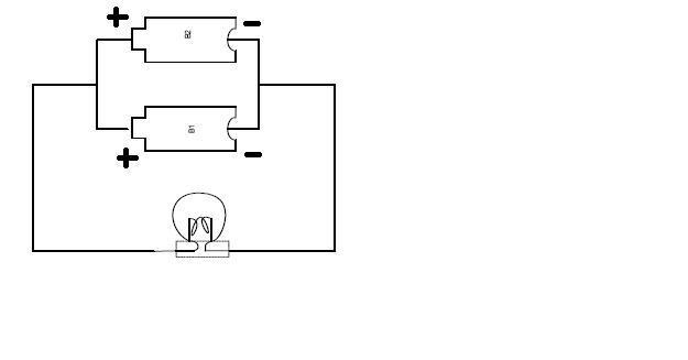

atwong713 said:
Can someone help me:
http://img199.imagevenue.com/img.php?image=14994_hw_122_452lo.jpg
for this configuration i was wondering do i add the voltages if each of them are 1.5V to find the voltage across the input terminals of the light bulb
what are your thougts?
Do you know any physical laws?
(you must give attempt to solution and some relevant equations/laws before you can get help, it is a part of the forum rules)
i know if its (-+)(-+) in series you add em n if its (-+)(+-) you subtract it right? but what if its like that? I'm guessing if they are 1.5V each then its 1.5v through the light bulb or since dey are in series den i add em so its 3V

Are you familiar with Kirchoffs loop law?
i'm not sure is it like if its a closed loop the net voltage has to equal zero or something? does that mean the answer is zero?

You are correct. Parallel sources do not add. There is 1.5V across the bulb.

But do you know how to apply a voltage meter?
thanks
but could you explain it a little and clear it up for me what would happen if they weren't the same voltage
atwong713 said:
no what's that?
ok, then never mind;)
Your guesses was right as Integral stated.
A voltage meter is applied parallel (over) the circut, so if you apply it over one emf you get 1.5V and that means that you must have 1.5V over the battery (I could have done a picture for you)
Using Kirchofs laws, you would find that there are no current in the upper loop, but that there are current in the lower, so "only one" battery will contribute.

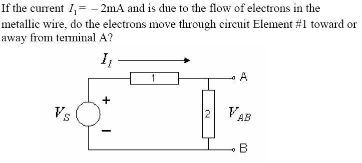

could you also help me on another problem and tell me if i got my facts straight
i say that it is moving away because if i say its positive going into element1 then since its negative its going out of element1 so its moving away from A

One thread for each problem, and use the template.
