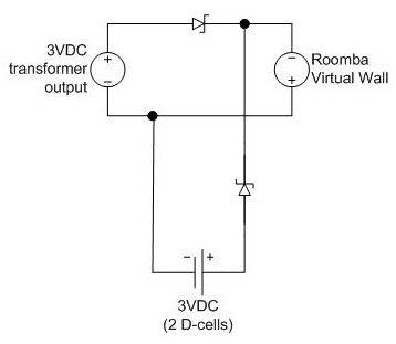

Awhile back we opened all of them up and converted them to run off 3V wall-warts. I had planned to just leave them turned on all the time -- a constant IR beam isn't going to bother anybody. Unfortunately, I didn't realize the invisible walls automatically turn themselves off after about 90 minutes if they're manually activated (instead of being programmed). Worse yet, it isn't feasible to simply program all of them using main power, since the programs would be frequently lost anyway: JEA, our electric provider, is extremely flaky. It isn't unusual to get a brief flicker once a day.
I've been wondering -- would it be safe and feasible to wire the battery tray in parallel with the wall-wart jack? (Obviously the two batteries would be wired together in series, and that would then be wired in parallel with the AC adapter to the circuit board.) Would the wall-wart feed the circuit and more or less indefinitely extend the battery life, which would only see a large drain when the main power went off?
Or would the lower amperage of the two-battery "cell" be the limiting factor, and the AC adapater would simply act as a second cell and match that amperage, and all I'd do is double the battery life? (Which is still nice, but not really the goal.)
When the power fails, is it reasonable to expect that the batteries could pick up the load of supply the memory with power after losing the wall-wart "cell"?

Thanks for all the suggestions! We have 12 of these, so I'm looking for the simplest possible angle, which makes the diode a great idea if it works. Not looking forward to building 12 copies of anything that involves soldering IC, or making breadboards, etc... They're distributed all over the house, so a centralized power source wouldn't work.
The leakage through a Schottky diode wouldn't be too much juice flowing into the battery?
Would I actually want two diodes? One to keep the power from flowing back through the transformer when the AC power goes down? Does my little Visio schematic look right?
It looks like low-voltage low-amperage Schottky diodes no more than a buck from Digikey -- although I need to do some reading to figure out exactly what some of the terms mean so I can choose the right one. (I'm not 100% sure which is the forward voltage and which is the reverse... although I guess I'd want them to be the same, right?)
That looks correct except for the reversed polarity on the Roomba unit. You shouldn't need the diode on the wall-wart supply, however, since it already incorporates one of more diodes, either in series or as a bridge; these convert the AC from the transformer into DC.
Oh yeah -- sorry about that, I hit the wrong button in Visio (looking for h-flip to put the text on the right and accidentally hit v-flip then forgot to flip it back).
Am I right in thinking that as long as the forward and reverse voltages are somewhere above my 3V requirement (there are quite a few out there in the 4V, 7V, 8V ranges), practically any Schottky diode should work?
I'm not really sure how to estimate the amperage they need to handle -- it was cheap and easy to find transformers that put out 1.5A and I knew the unit drew less than that, so I didn't worry about guessing what it actually needs. But now I suppose I have to know. I've seen "RF" diodes that seem to have very, very tiny ratings (like 50mA) and I would assume I don't want that, but those are mostly what I'm seeing in the lower voltage ranges.
Any suggestions?

You would also need to make sure the wall supply delivered more voltage than the batteries.
This is necessary to reverse bias the diode in series with the batteries when power is available.
Otherwise, the batteries would be delivering power all the time.
One way to do this would be to use NiCd or NiMH batteries and put a suitable resistor (maybe 470 ohms) across the diode to trickle charge the batteries when the power is available.

vk6kro, please define "put a resistor across the diode"... are you saying basically "loop around" the diode with a connection through the resistor? The diode blocks the full current, but the resistor circuit allows a small amount to bypass it? How does one determine what size resistor is appropriate for this (out of curiosity)?
I suppose I need to see peak amperage, and I assume that would be with the virtual wall "on" -- spewing it's IR signals through its two LEDs. I can just power it up and watch it for awhile, the meter I have can hold a peak value.
That's it. The diode allows full current to flow from the battery to the circuit under power, but the resistor allows a small charging current to flow through the battery when the AC power is available. Obviously, for this to work the AC supply voltage needs to be a few volts above the battery voltage. The resistor value will be chosen to limit the current through the batteries to a safe charging level, typically C (the battery capacity in mAH) / 20 for a trickle charge.
Awesome. I think I have everything I need then.
Hmm -- any tips on how to spec out the correct diode? Digikey had a rather vast number of search parameters for diodes...
Also -- why mAH/20? Where does the 20 come from? (Again, just curious.)
C/20 is the standard trickle-charge rate for NiCds, although almost all cells can take a C/10 charge indefinitely without significant voltage depression problems. I assume the industry arrived at that rate through experimentation, but I'm not sure.
The diode should have the lowest forward voltage drop and a forward current greater than your expected peak load (add, say, 10-20% to any measured figure for safety) and a peak inverse voltage rating greater than the supply voltage. No other characteristics matter for this application.

I had a look at Digikey.
This part:
MBR0520LDKR-ND
Has a rating of 20 volts inverse and 500 mA max current so it probably has adequate ratings. The price was about 28 cents and you can get them in small quantities.
It has a forward voltage drop of 0.385 volts at 500 mA, though, so I wonder if normal Si diodes might be adequate. You'd probably need 3 rechargable NiMHs anyway and you would then get about 3 volts after the diode. ( (3 * 1.2) - 0.6)
You can reduce the trickle current if you know the batteries are only going to be used rarely.
470 ohms would give about 4 mA if the supply was 5 volts or 2 mA if it was 4 volts. Maybe as low as 100 ohms.
Basically, they should never go flat, so the trickle current only gives them a boost to compensate for their normal loss of capacity with time.
You would need to measure the wall wart supply voltage and current drain with a multimeter to get it right.

Yes, I've seen wall warts that give double their full load voltage on no load. Some of them run pretty hot, too.
Good quality ones give a steady regulated voltage, but these might be pulsing DC with no filtering.
Hmm... and these are the cheapest of the cheap, frankly. I think I paid about $5 each for them, or something like that, and I'm sure even that was a ripoff (but roughly the same as 2 month's worth of D-cells...)
I suppose I should try testing them under load, then? Maybe power up the Roomba virtual wall's LEDs then put the meter on it to see what voltage is flowing? Should I expect the other stuff I'll be adding (diodes, resistors, batteries) to further contribute to significant voltage drop over whatever I can measure off the current transformer/unit-only setup?
Measure the voltage across the output or the wall-wart with no load first.
Then if you have an electrolytic capacitor put this across the output and measure again.
If the voltage goes up, the supply isn't filtered.
Then judge whether it is safe to put the supply across the LED units or bring the readings back here.
Read what it says about voltage, if there is a label on the LED units.
The only voltage drops should be in series with the batteries, so the full voltage of the power supply should get to the LEDs.
