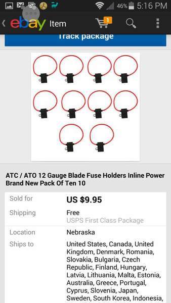

Here's my dilemma: I want to use one fuse and attach 3 or 4 of the 12 gauge wires to it (I chose 12 so the wires wouldn't be the limiting factor, I'll see the amp rating of my devices so I can put a low enough amp fuse so I don't blow my items I plug in). I'd get a fuse tap, but the wires that come on it look a bit flimsy, and I want to split it 3 or 4 ways. I basically want to know how to split my power 3 or 4 ways. I have enough wires, I have extra fuses that I bought, and 10 inline fuse protectors too (full list below)... But how do I get 3 or 4 wires to connect to the 1 fuse? Do I connect 1 to it, then use a quick splice wire tap that cuts into the protective outer layer of the wire, then put heat shrink on it, then tap that one, then tap the next and the next? How would you go about splitting the current 3 or 4 ways? Is there any other type of wire splitter? Like how we have for coax cables that can split the power? Is the

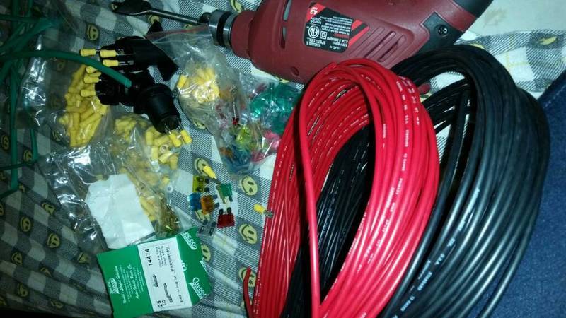

I ordered a few cigarette lighters from eBay some 12 gauge wires black and red 50 foot ones, a 10 pack of 12 gauge inline fuse protectors, yellow butt connectors (for 12 gauge), some ATC fuse taps (some said hot, some didn't) and crimp on female parts that attach the 12G wires to them. some crimp connectors that would attach my 12G wires to the cigarette lighter, heat shrink tubing (0.5mm) wire protectors an assortment of ATC fuses (standard size, not mini). Solder, a soldering iron, wire cutters that come with the crimping ability and stripping ability. A volt meter.
I have a drill, which I'll find before the items get here, but I'm sure I'll need to buy bigger bits for it, or maybe use the ones I have and just extend the hole.
Right now, the car needs some work, and the plastic is missing from under the steering wheel, it needs new door handles, both power windows on the passenger side don't work (maybe a blown fuse or loose/faulty wire), may need a new ignition cylinder, and the wires are already exposed, so I figured I'd get this done before my mom and her boyfriend go to get the pieces for it and get them attached and fixed up.
To be honest, I've never done this before, but I did a hefty bit of online researching, and YouTube video watching, and found all the parts I'd need, and went through it in my head how I'd do it many times, but just never saw anyone doing more than 1 cigarette lighter install...and I'm trying not to tie up too many fuses since the guy my mom used to install her viper will need some for the viper he's going to install in mine...after it's fixed up.

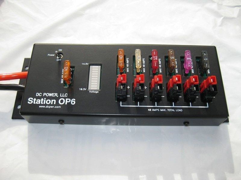

Sounds a bit dangerous, but here is what we use to wire up power to HAM radio gear in cars:
https://www.google.com/search?aq=&r...urce=og&sa=N&tab=wi&ei=lyT9U8zvAef9iwK4o4GgDQ
The Anderson PowerPole connectors and distribution strips offer a clean, professional (and fused) way to handle moderate power in 12V systems (like in cars). Check them out to see if you can use them.

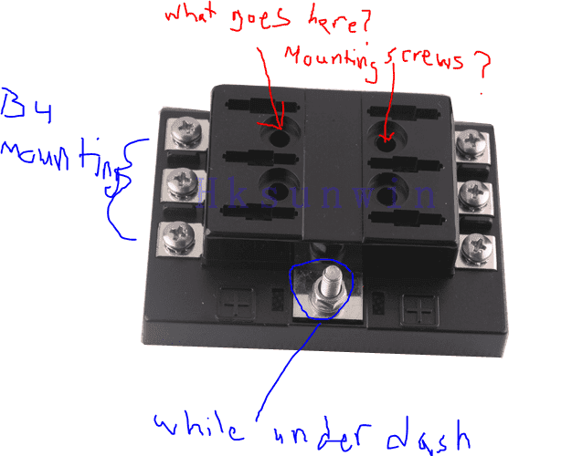

Ok Berkeman, I think I see what I can do with this. Looks like it'd have to be hooked directly to the battery, right? Then I can turn on the switch when I'm ready to use it. I wish I could find something exactly like that that would turn on with the car like the accessories in the car do. That's what I was looking for at first, but don't know what to call them, or if they're even sold. I'm going to look at prices for this.
As soon as my parts come in, I'm going to look to see what I can do.

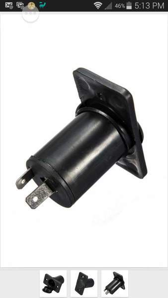

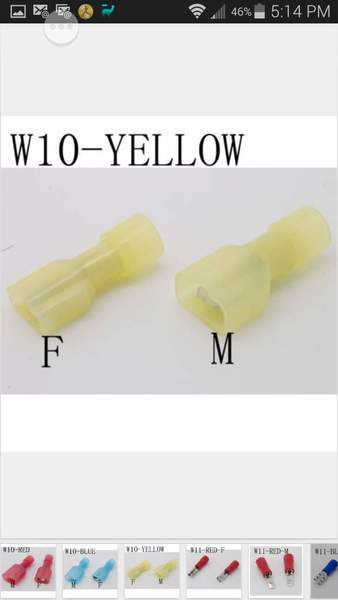

Oh, & sorry. I meant sockets for cigarette lighters to power low power devices like cell phones/tablets, dash cams, GPS, etc. Not the actual one that can light a cigarette. Thanks for clearing that up for me. I'm making the red leads for the cig lighter sockets too btw. These come without wires so I done have to worry about wire quality. So you're saying I don't even need to tap the fuse? Just tap the wire with a quick splice wire tap? I was planning on starting closer to the source just in case the cig lighter installed had an old high gauge wire. I will check out the wire this weekend when I'm off and see how durable & big it looks. Can't start anything but mapping out until I get the parts in the mail though, sigh.

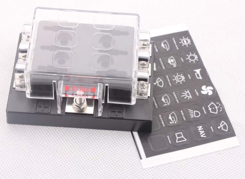

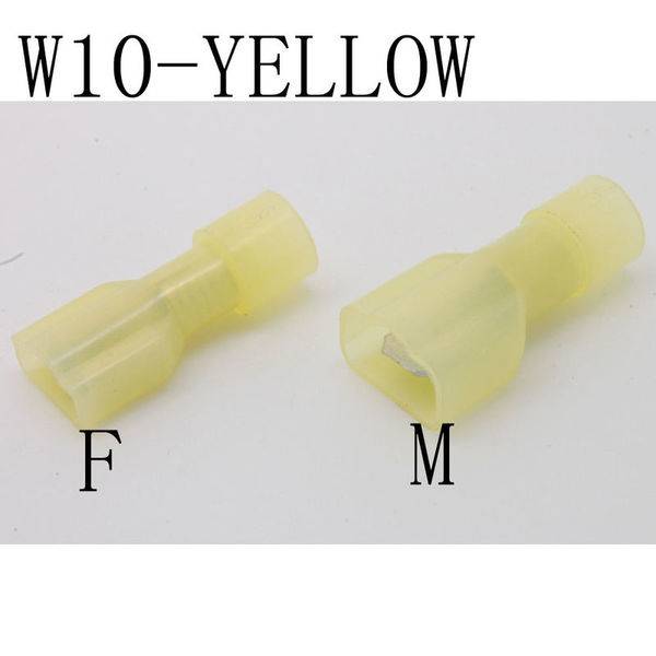

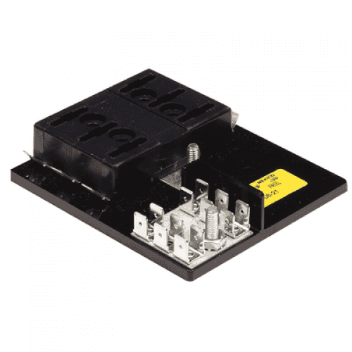

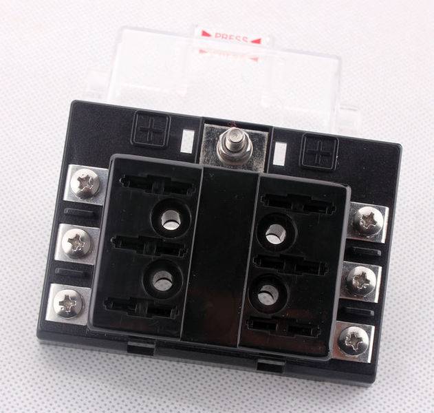

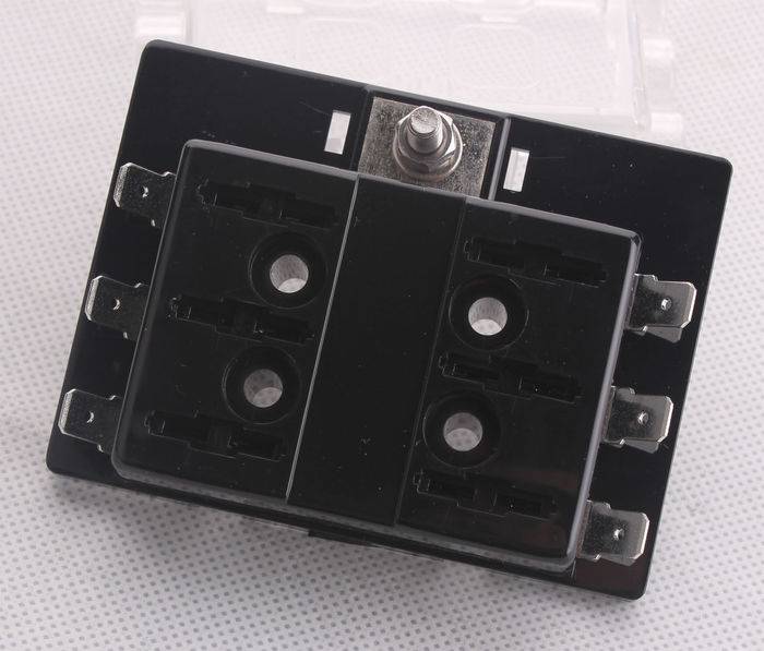

Thanks! I'm going to try to find something like that but with blade fuses (only because I bought a bunch of blade fuses already, lol) but this looks awesome! If you can think of it, someone already invented it. :)
Which one would you use? With Screws, or connectors?
My cigarette lighter sockets are coming from China, so they will take a while to get here anyway.
There are 3 fuse box distribution blocks that I'm looking at on eBay.
One has screws, (China)
one has a male connectors, (China)
and the other has male connectors and grounding screws but no cover for fuse box was listed (USA)
I'm wondering if the one with screws is more secure only because If something happened to a screw, I could just replace the screw, but if something happened to the male connector, I'd have to do some soldering and more work to fix it.
(I already have these coming in the mail)
Female

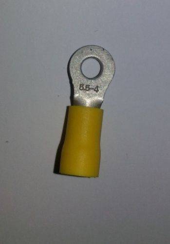

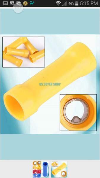

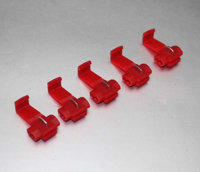

It's a personal preference.
I worked in an industrial place where we allowed only ring lugs like you pictured. They are secure... but laying on your back holding a flashlight in your teeth with dust falling in your eyes from under the car dash, trying to manipulate a flat screwdriver into a slotted screw head that's in the shadows is no fun. If you buy screw terminal connecters - look for Phillips heads.
And prefabricate your wires - do your soldering on the workbench.
if instead you use push-on connectors get the ones fully covered by insulation. Be aware they come in different widths...
For car work a good crimp is okay but requires a tool. I have this one from a home supply store.
http://www.homedepot.com/p/Klein-To...ing-Tool-J1005/100647831?N=5yc1vZbofeZ1z1181bbut a lot of people use this:
http://www.aircraftspruce.com/catalog/topages/crimptool.php
they're available most everywhere in varying degrees of quality.
If you anticipate doing a lot of electrical work get yourself a really good crimp tool. For just occasional odd jobs the cheap little flat crimper will get you by. Its thread repair capability is handy.
A fellow really ought to have both tools. Believe me word will get around that you're handy.
Lastly- when you crimp with the better crimper put the dent opposite the split.

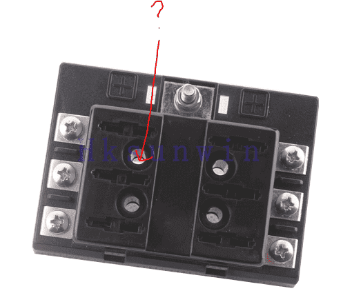

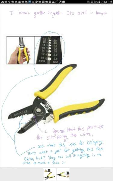

This is the tool that I ordered online. A little el-cheapo multi use one since I don't anticipate using it more than once in a while.
I think I'll attach the majority of my wires to the 6-way terminal fuse box before I go under the dash. The only ones I'd have to be under there for are the ones that'll attach from my power source to the 6-way terminal fuse box. I'll even keep the wire that was originally going from the cigarette lighter to the power attached to the cigarette lighter, and attach it to the 6-way fuse box. I may change the fuse though, depending on how big it is (seeing as there will be fuses in the 6-way fuse box anyway, I think I should check the amp rating on all the devices and make it powerful enough for everything that will go in there to go in at the same time.) They'll each only pull the amount of power the device asks for anyway, right? So I don't have to worry about fuses blowing b/c the fuse before it is more powerful? The weakest link will not be the wire, which will be a 12 gauge, which can safely accept up to 20A...All devices connected at once definitely won't exceed 20A anyway, so I may end up using a 15A fuse there if it isn't already there.
Guess I won't need the in-line fuse holders for this project, but they're still useful to have around. :)
I haven't gotten it yet, so I'm not sure if the holes I pointed out in red are for mounting, or for grounding, or for both... I'm still waiting for it to come in the mail. They go all the way through
and seem to be smooth, not ridged.
I'm going to be using the crimp on ring terminals, but will solder it too for good measure.

The tool you pictured is a wire stripper, not a crimper. You need something that will do good crimps. Without a good crimping tool I cannot recommend crimping at all. Bad crimps are worthless, solder if you cannot get a good crimp. Test all crimps with a firm pull, if the connector comes off, you did not get a good crimpl
i think i smell trouble.
The fuse that's in the car now is sized to protect that wire going to your cigarette lighter.
It is not intended to protect what's plugged in or connected to the cigarette lighter.
So you must NOT replace that fuse with a bigger one. That risks burning up the wiring harness which is a really expensive repair.
EDIT Assuming you power the six way fuseblock from the existing cigarette lighter, the total load you connect to all your outlets must not overload that wire going to your cigarette lighter. That's why it's fused.
Chances are you won't have 5 amp loads plugged in everywhere at once. And if you do , you don't want wires melting.
If instead you run a new wire from power to the six way, as RBTO suggests, yes you can fuse it for whatever that wire can take.

And darn, this is really just a stripper, not a crimp tool?
http://www.ebay.com/itm/321479820887?_trksid=p2059210.m2749.l2649&ssPageName=STRK%3AMEBIDX%3AIT
grr ebay. It said it was a "Plastic Handle Wire Stripper Cutter Crimper Automatic Crimping Striping Tool" in the description/title. It was only like $5 anyway, but I basically wasted all that time waiting for it when I could have gone to home depot or something and gotten one...Can't drive it yet or turn it on to do any power tests until I get the ignition lock cylinder replaced (By a pro) or I would've gone already.

ring terminals too small to go over car battery
So, while someone was installing my ignition key cylinder, I decided to start hooking up my cigarette lighter sockets, running the wires and everything. They said I should just connect it to the car battery instead of trying to get to the wires for the cigarette lighter. I said it would be always on, he said it's okay, because the ones in some cars are like that, and it's fine... BUT the ring terminals I got were too small to fit over my car battery...da da dum These were the ones I had gotten...
but from a different seller.
So I see others that are different.
They aren't ring, they are more horseshoe shaped. Do you think I should try those instead? I have the wires strung through just waiting to be hooked up, got the power from a neighbor who has an extension cable & I was able to use my drill and make a perfect looking hole. I'm getting different screws (shorter but the same diameter so my ring terminals can ground my ground wires. Found a great spot, but need smaller screws and nuts and bolts to fit those screws.
So do you think it would better to get the horseshoe ones #6 like listed above instead of these #6 below so I won't be trying to go with this and praying it's not too small again?

Horseshoe connectors:
IMO, they are not suitable for that high current location. They will actually restrict the effective contact area of the start lead ring connector by standing off the bits where the gap is.
Horseshoe would never (?) be used on a starter lead. Any opinions?
Likes 1 person
can't remember seeing one, for what little my memory is worth.
I don't like them because they spread out from under the nut.
I'll only use small ones with an undercut binder head machine screw.
Undercut grabs the lug like a pincer.
http://www.smithfast.com/bindhead.html

They have their place. Infinitely more convenient for signal leads than ring connectors (telephone blocks in the old days). I have used them on my boat for electronics and they don't pull off like spade connectors ( which I also use a lot).
Thanks, that's good to know. I'm going to get some bigger ring terminals to ground my wires, because there's a screw that I can use, but it's too big. I'll get a few nuts and bolts while I'm at it to make it extra secure. Wouldn't want a ground wire slipping out.
I know you want to finish this project sooner than yesterday, but it might pay you to get a copy of the Parts Express catalog. They have just the automotive connection devices you're looking for on pages 320-22 of their current catalog. There's a distribution block, heavy duty lugs, and battery posts with wing-nut connections, most all of this gold plated but reasonable in price.
Here's a link to a couple of items that you might incorporate:
http://www.parts-express.com/gold-plated-barrier-spade-lug-connector-screw-type--095-678
http://www.parts-express.com/p3-gold-positive-(-)-battery-terminal-block--263-679
http://www.parts-express.com/p3-gold-distribution-block-1x4--263-671
http://www.parts-express.com/wafer-fuse-holder--263-630
These might make your job a lot easier and safer by incorporating fusing from the main battery terminal.
