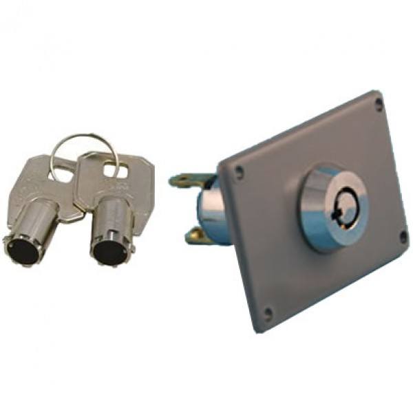

Why not just replace the simple switch with a locking switch? What does the current simple switch look like?
http://plywoodchair.com/wp-content/...ck-Replacement-Amusing-Design-Garage-Door.jpg

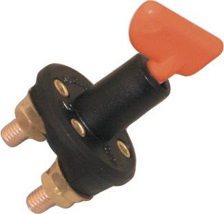

Mount a battery switch close to the battery - I would use a switch like this (meant for boats):
Then your existing switch does all it is supposed to do, but you can disable everything with the battery switch.

That would be an option if the design was not this clean and if there was room for something like this. That's why I want a remote. So it won't be visible and ruin the clean modern look. Thanks for your reply though!
