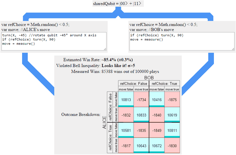

You may be interested in viewing an interactive widget I made to simulate the CHSH test as part of a blog post, to get ideas. You can view it directly on jsfiddle, or in the blog post (with explanation of how to use it). Also you can edit it on jsfiddle. Here's a screenshot:

Nice animation, nice to be able to insert javascript. Never used fiddle, but was able to copy to what I am used to using and am able to work with it. Two quick questions:
1/ Your "photons" are shot with 2 independent random polarizations, rather then being split from a common photon and both photons having the same Jones vector?
2/ I could not find the turn(x,90) or the measure() functions, maybe I am looking in the wrong file?
Thanks, I hope to have fun and let you know.

It would be more accurate to say that my simulation has two polarizations than to say it has whole photons. Polarization is a 2-level quantum system, a qubit, and the post is framed in terms of qubits. The qubits are entangled to have agreeing value and phase, which corresponds roughly to saying two polarizations will agree both horizontally and diagonally (whichever one you check first).
The measure function is defined at line 217 of src/Engine/ChSh.js; it's just a simple wrapper around code in src/Engine/Superposition.js.
They're written inside strings instead of directly in the code because the widget uses web workers to avoid blocking the browser while running simulations. There's also some string interpolation happening to make escaping the sandbox a bit harder. Also it's not using any math libraries or anything, just direct twiddling of numbers inside a buffer. And the code on jsfiddle has been transpiled by traceur into ES5. So I'm not too surprised you had trouble finding the measure function.

Thanks, I will have a look.
WRT to polarizations, perhaps I am miss-reading, but you assign var refChoice = Math.random() < 0.5; to Alice, then a second var refChoice = Math.random() < 0.5; to Bob, I don't see how these are entangled? Here's where I would assign the same Jones vector to both.
The entanglement is in the fake `sharedQubits` variable, which is only worked with indirectly via `measure` and `turn`. In the code the entangled state is stored as a list of 8 floats representing 4 complex amplitudes, and Alice and Bob's operations fiddle with the list in the way described by the postulates of QM.
The 'refChoice' variable is the referee's choice, not the entangled qubit. Each player gets an independent random referee bit. The CHSH game is for two isolated players to pick bits satisfying ##a \oplus b = x \land y##, where ##a, b## are the players' respective chosen bits and ##x, y## are random bits (chosen by referee to prevent cheating) fed respectively to each player once they're isolated (and ideally at the last possible moment, to close the signalling loophole).
