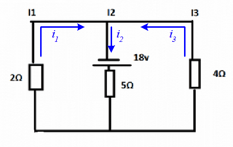

I have to calculate the current through each branch - I1, I2 and I3.
The only reason I'm having trouble with this problem is because the voltage source is in the middle and I'm a little confused. I am struggling even to add up the resistances.
Are the 2, 5, and 4Ω resistors in series with each other? Do I just add them all up to get the total resistance?
After I have the total resistance, I calculated the supply current (I2) by just using ohms law.
How is it I calculate I1 and I3? Is it current division?
You can use KVL in the two loops..

The resistors are not in series. In fact you should be able to confirm quite easily that the 2 and 4 Ohm resistors are in parallel (they share the same potential difference as their leads are connected to the same two nodes). In fact, there are three parallel branches comprising the circuit. What does that tell you about the potential difference across all three? What relationship exists between the three branch currents (think KCL).
Draw in the currents:
Can you write KCL and KVL equations for the circuit?

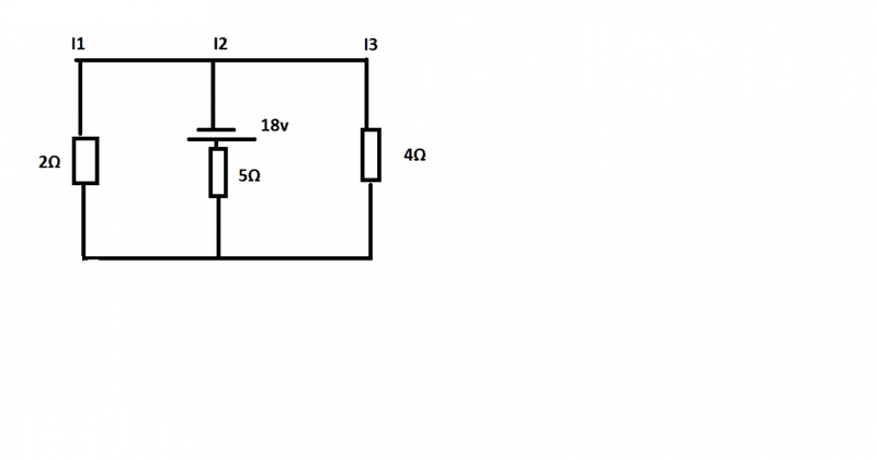

Yes, I had a 32V on the right, which I already dealt with. It's removed, now I'm left with the 18V source.

Is the total resistance for that circuit 6.3 ohms?
For KVL, it doesn't matter. But looking at the circuit, no two resistors are in series or in parallel.
Edit: 2 and 4 are in parallel..sorry! I drew it wrong..
6.33Ω, yes.

The first question I have on my question paper is:
Determine the current flowing through the 4 ohm resistor and the voltage drop across it using Kirchoff's laws, which I completed fine.
The next question is:
Determine the current flowing through the 4 ohm resistor and the voltage drop across it using superposition theorem.
Usually what I have is a circuit with two voltage sources. I remove one, calculate the total resistance and then the current in each branch.
I then remove the second voltage source and do the same thing - calculate the total resistance and then the current in each branch.
I then draw a matrix table thing to calculate the total current in each branch.

I calculated that the supply current (I2) is 2.86A. Is this correct? If so, how do I now go from that to calculating I1 and I3? Can I do current division or something?
You can use current division since 2 ohm and 4 ohm are in parallel.
So I3 = 0.953A and I1 = 1.906
Is that correct?
Is that correct?
Yes.
