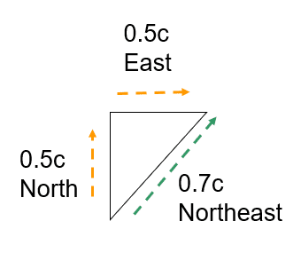

Good evening,
If a ship is moving at 0.5C east in a gravity free environment, and fires a bullet perpendicular at 0.5c, is it just the hypotenuse (a squared + b squared)/c squared that we use for the speed?
Or is there more to it since we are at great speed?
Does 0.5c north + 0.5c east = 0.7c Northeast? The link doesn't tackle perpendicular velocity additions.
Thanks.

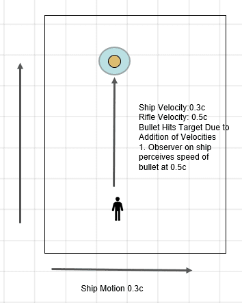

So, the observer on the ship still sees the bullet moving at 0.5c, even though the ship is moving 0.3. Addition of velocities keeps it on target and same speed relative to observer on ship, but observer outside sees it diagonally higher speed.
Yes. The sum is ##\frac{\sqrt{2}}{2}\,c##, appoximately .707c.
Okay - a bullet moving 0.5c north inside a train also going 0.5c east would be seen by an outside of the train observer at 0.707c northeast.
According to an observer on the ship, the ship isn't moving. Shooting is just the same as anywhere else. It's only when observed from a frame where the ship is in motion that it starts to look more complicated.
Awesome - got it it just clicked.

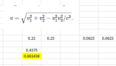

That is not correct. Consider the limit as the speeds approach c - you would get c√2
Correct, per the formula given in my linked post above, is ((√7)/4 ) c, about .6614 c.
So the speed is not 0.7.
There are a lot of formulas in that link and it is hard to follow, and some if what is written there is incorrect.
Can you tell me the exact formula to determine speed of two velocities, both 0.5C, one on the x and one on the y axis?

In the link I gave to my old post on this, about half way down I give a formula specifically for the orthogonal case.
Also, of note, is that the direction of the resulting velocity would be about 40.89 degrees rather than 45, due to a type of aberration.

all of the V's in this case are .5c. Is this it?
And it is less than 0.7, due to the length contraction in the X axis. In any case, impact location remains the same.
Not quite. I use c=1 convention. So all velocities are over c. Putting c back, would give
√ (u2/ c2 + v2/c2 - u2v2/c4)
[edit: wait, you are correct, because what I just wrote above would be multiplied by c to give a result speed rather than speed over c. Once you do that, you get your formula. ]
Okay, and you got the .6614, same as I got. Yes I am using c=1, but the V, they are all 0.5. IE, v/c = 0.5/1/
