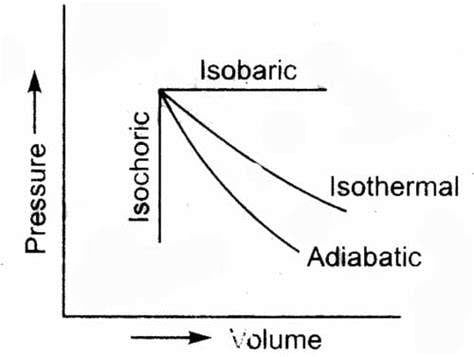

What the OP doesn't realize is that, in the first case, energy is released from the fluid to produce work. In the second case, energy must be added to the fluid while producing work.
From the graph above, the work (i.e. the area under the curves) between the isobaric and adiabatic cases is very different.
What you should also notice from the above graph is that the final temperatures are also much different. The isothermal case gives you an indication of the direction of constant temperature. The adiabatic case must drop in temperature but the isobaric case must increase - a lot - in temperature. This means that energy must be added to the system somehow.
This is essentially the difference between the Otto cycle and the Diesel cycle: The former adds all the energy (combustion) before it expands and the latter adds the energy while it expands. But for the same amount of energy addition, the initial conditions for the expansion are much much different.
jack action said:
I think you believe wrong. The OP never mentioned the isobaric case was adiabatic.
His second case is that the exterior pressure is constant at 10 psig and the volume increases.
