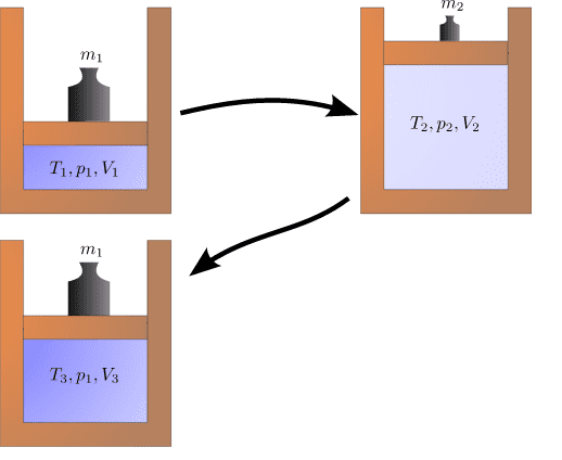

In summary, the example from the Wikipedia page on irreversible processes explains how the initial state of a perfect insulator cylinder cannot be reached after it is changed, due to energy being converted into heat during the transitions. The presence of friction between the piston and cylinder also leads to an increase in entropy and results in the inability to return to the original state. The effect of letting the gas expand freely or assuming frictionless conditions would result in the same outcome of adding heat to the gas and increasing its volume and temperature. However, if an additional external force is applied to allow the gas to expand gradually, the process can be reversible and result in a lower final temperature. Similarly, gradual compression can also be reversible and result in a lower final temperature compared to
Razvan
53
This example is taken from the wikipedia page describing irreversible processes.
If the cylinder is a perfect insulator, the initial top-left state cannot be reached anymore after it is changed to the one on the top-right. Instead, the state on the bottom left is assumed when going back to the original pressure because energy is converted into heat.
I just want to make sure I understand correctly why the initial state can't be reached anymore. I assume the transitions to be quasi-static, but there is friction between the piston and the cylinder. If so, during the transition from state 1 to state 2, when the piston rises, some of the work is transformed into heat, which increases the internal energy of the gas. During the compression, again, some of the work is turned into heat, so the pressure from state 1 is now achieved at a higher volume (because some work was converted into internal energy). So the entropy of the system (or universe) has increased.
Is this correct?

No. The description implicitly assumes that the piston is frictionless. Also, if the deformation were quasi-static, then the process would be reversible, and the system and surroundings could actually be returned to their initial states. What is happening here is that the mass m1 is being replaced by a much smaller mass m2, and the gas is then being allowed to expand rapidly and irreversibly. The irreversibility comes in because the expansion will be very rapid, and the gas will experience viscous dissipation of mechanical energy to heat. This is essentially the same thing that happens in a spring-mass-damper system, with the damper being analogous to the viscous dissipation in the gas. If the spring-mass-damper system is made to deform quasi-statically, then the damper will not dissipate significant mechanical energy (because its effect is proportional to the rate of deformation), and the deformation will be reversible. However, if the system is allowed to deform rapidly, then the damper will dissipate significant mechanical energy to heat.
When the smaller mass m2 is replaced by the larger mass m1 and the gas is allowed to compress rapidly and irreversibly, the same thing happens again. Here again viscous dissipation comes in.

No. Please forget about friction. What they are trying to explain happens without friction. You can still expand the gas quasistatically even without friction, by applying an additional external force to allow the piston to rise gradually. Here are the two cases:
1. Additional external force applied to piston so that gas expands gradually (rather than rapidly). Gas expansion takes place adiabatically and reversibly. Negligible viscous heating occurs in gas.
2. No supplemental external force applied to piston so that gas expands rapidly. Gas expansion takes place adiabatically, but irreversibly. Significant viscous heating occurs in gas. Final pressure is the same as in case 1.
In both cases, the gas cools when it expands, but the final temperature in case 1 (the reversible case) is lower than in case 2 (the irreversible case).

Chet
Problem Statement
We have a gas in a vertical cylinder of cross sectional area A. There is a massless, frictionless piston sitting on top of the gas, and a large mass m1 sitting on top of the piston. The cylinder is contained in a vacuum chamber so that the absolute pressure in the room surrounding the cylinder is zero (this makes solving the problem a little easier). The cylinder/piston combination is perfectly insulated, so that any expansion or contraction of the gas occurs adiabatically. The system is initially at thermodynamic equilibrium at temperature T0 and volume V0. The initial pressure of the gas in the cylinder is m1g/A.
We are going to consider the reversible expansion of the gas and the irreversible expansion of the gas, both to a new pressure m2g/A.
Reversible Expansion: In the reversible expansion, we replace the mass m1 with a new mass m2, and start out by holding the piston down manually with an additional downward force m1g - m2g. We then very gradually ease off on the additional downward force until it is zero.
Irreversible Expansion: In the irreverislbe expansion, we again replace the mass m1 with a new mass m2, and start out by holding the piston down manually with an additional downward force m1g - m2g. However, in this case, rather than very gradually easing off on the additional downward force, we remove it suddenly (i.e., drop it to zero) and let nature take its course until the system finally equilibrates on its own.
Our goal is to determine the final temperature and volume of the gas in each of these two cases.
Is this problem statement satisfactory to you?

Irreversible Case
The key to doing the irreversible case is to figure out how to get the work done by the gas on the surroundings (i.e., the piston and the mass m2).
We're going to assume that the mass m2 is glued to the piston, so it can't separate from the piston if oscillation is involved.
As you mentioned, in the irreversible case, the pressure of the gas and the temperature of the gas will not be uniform within the cylinder during the expansion, so we can't use the ideal gas law (except at the initial and final states). But we have to ask ourselves, "what really determines the amount of work that the gas does on the surroundings?" Well, the work done on the surroundings is determined soley by the force that the gas exerts at the base of the piston, FI, where the subscript I refers to the interface between the system (the gas) and the surroundings (the piston and mass). This interface is the only location where the gas does work on the surroundings. The work is equal to the integral of FIdx, where dx is the upward displacement of the piston. Thus,
$$W=\int{F_Idx}$$
But, how can we get the work on the surroundings if we can't use the ideal gas law to get the force on the interface? Well, to get that for the irreversible case, we need to turn attention to what is happening on the other side of the interface (the piston and mass combo).
Even though this is a course in thermodynamics, there is no reason why we are not allowed to use what we learned in freshman physics (mechanics) to help us. Suppose I write a Newton's second law force balance on the piston and mass. Then we have:
$$m_2\frac{d^2x}{dt^2}=F_I-m_2g$$
Now, suppose we multiply this equation by the velocity v = dx/dt and integrate from time t = 0 when the piston is released to some arbitrary time t. We obtain:
$$\int_0^t{\frac{m_2}{2}\frac{d}{dt}\left(\frac{dx}{dt}\right)^2dt}=\int_0^t{F\frac{dx}{dt}dt}-m_2gx(t)$$
Do you see how I obtained this equation?
Now, the left hand side of this equation integrates to:
$$\int_0^t{\frac{m_2}{2}\frac{d}{dt}\left(\frac{dx}{dt}\right)^2dt}=m_2\frac{v^2(t)}{2}=KE(t)$$
where KE(t) is the kinetic energy of the mass m2 at time t.
The term ##\int_0^t{F\frac{dx}{dt}dt}## integrates to:
$$\int_0^t{F\frac{dx}{dt}dt}=\int_{x=0}^{x=x(t)}{Fdx}=W(t)$$
where W(t) is the cumulative amount of work that the gas does on the piston/mass combo up to time t.
Therefore, if we combine these results, we have that:
$$W(t)=KE(t)+\frac{m_2g}{A}(V(t)-V_0)$$
Now, we expect that, in the irreversible case, the mass will start out by overshooting its final equilibrium position, and will oscillate about this location. However, as time progresses, as a result of viscous dissipation in the gas, the oscillation will gradually decay to zero. In the final equilibrium state at infinite time, the kinetic energy of the mass will be zero. Therefore, the work that the gas does on the surroundings between the initial and final equilibrium states will simply be given by:
$$W=W(∞)=\frac{m_2g}{A}(V_f-V_0)$$
This is the result that we have been looking for.
I'm going to stop here and give you a chance to digest all this.

Nice work!
Yes, it's correct for γ=5/3. But, how about expressing it in terms of γ? And the final temperature in terms of γ is?

Very nice. I really like your style, particularly the way you manipulated the results into their final forms.
If you still have any energy left, you can compare the final results for the temperatures in the two cases pretty easily by expanding each of them in a power series in ε = (m1-m2)/m1. The linear terms in the two series will match exactly, but the quadratic terms will differ (in the way that you would expect).

Very nice indeed. So the conclusion is that, as expected, the amount of cooling when expanding with the reversible case is more than when expanding with the irreversible case. These same equations also apply to compression. The amount of compressional heating with the reversible case is less than with the irreversible case.
