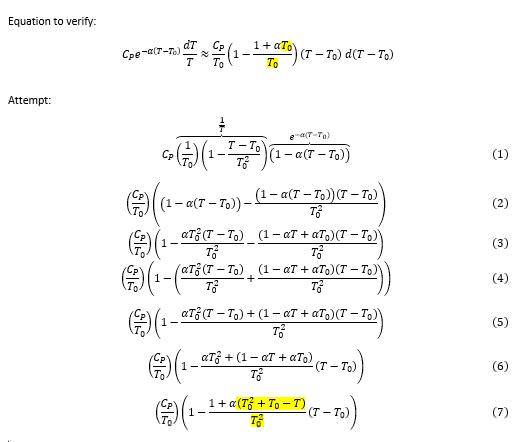

I tried to verify your equation but was unsuccessful. Here is my process:
Here's what I get when I make the substitutions shown in post #10:
$$C_pe^{-\alpha (T-T_0)}\frac{dT}{T}\approx C_p[1-\alpha (T-T_0)]\left[\frac{1}{T_0}-\frac{(T-T_0)}{T_0^2}\right]d(T-T_0)$$If I retain only linear terms in ##(T-T_0)## in the integrand, I obtain:$$C_pe^{-\alpha (T-T_0)}\frac{dT}{T}\approx \frac{C_p}{T_0}\left[1-\alpha (T-T_0)-\frac{(T-T_0)}{T_0}\right]d(T-T_0)$$If I combine the two coefficients of ##T-T_0## in the brackets, I obtain:
$$C_pe^{-\alpha (T-T_0)}\frac{dT}{T}\approx \frac{C_p}{T_0}\left[1-\left(\alpha +\frac{1}{T_0}\right)(T-T_0)\right]d(T-T_0)$$
