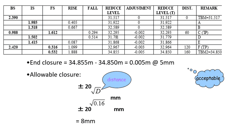

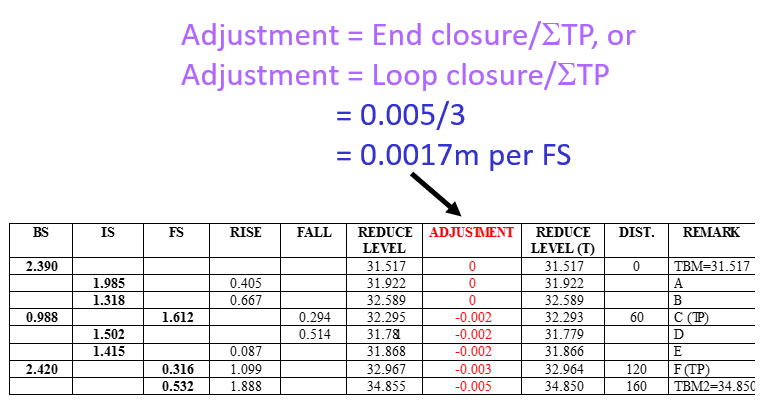

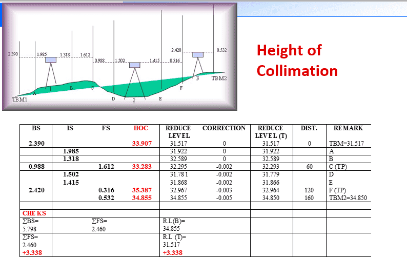

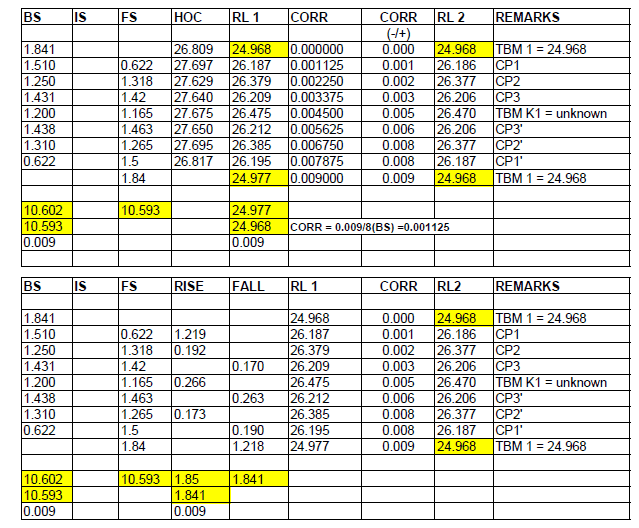

in photo 391 , we can see that the levelling work is back to the same point , which is TBM1 . so , the adjustment of correction is (Bs -Fs ) / number of points ... But in 392-394 , the levelling work is from a known point to a different point ...
I'm wondering that is the adjustment correct ? It's given that adjustment = end closure / number of TP ...
In the table provided , we can see that there are only 2 TP , why the author divided by 3 for the case in 392-394 ? [/B]

are 392-394 wrong ? because the correction are not applied to first 3 reading ...
