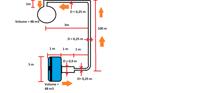

Hi all guys I'm new on this forum, and I write this post to ask you for help on a mechanical engineering, hydrodynamic, advanced level problem that I am not able to solve and I hope that some of you certainly better than me can to help.
The problem is the following: (I enclose the hydraulic diagram, sorry I know it is not accurate, I did it again on the fly on the PC by copying it from the workbook, unfortunately it is not to scale but it should still be useful to understand the exercise).
Find the amount of force that must be applied to the hydraulic piston, placed in the blue tank at the bottom, containing 48 thousand liters of water to empty it in 25 seconds through a tube of 0.9m diameter and 1m length which narrows to a 0.25m diameter and 105m length connected up to the spherical tank also of 48 m3 placed at the top.
Fluid density of water at 20 degrees Celsius = 998.21 kg / m ^ 3
Dynamic viscosity of water at 20 degrees Celsius = 0.001002 Pa.s
tank bottom volume 48 m3 (5m * 9.6m * 1m)
while the tank at the top is always 48 m3 but it is spherical
style='font-size:16.0pt;font-family:"inherit",serif;color:#202124;mso-ansi-language:
EN'>='font-size:16.0pt;font-family:"inherit",serif;color:#202124'>
To calculate :
- Total force to be applied to the piston to empty the tank in the indicated time, considering the continuous and localized pressure drops (steel tube with very low roughness) and all frictions.
- Piston power in kWh
Practically the piston has a stroke of 1 meter and it is necessary to calculate the force and power of the latter necessary to empty the tank at the bottom completely and consequently fill the spherical tank of the same volume placed at the top.
I tried to solve it, calculating the necessary force and I get about 3000 kN with a power of 1050 kWh, but I don't know where I am wrong and the result does not lead to that of the exercise. I calculated the head losses in the 2 narrowings, in the 3 curves, the continuous head losses and the necessary outflow force from the tank, to calculate the power I first calculated the work but nothing to do.
I thank anyone in advance who can solve the problem and help me.

Welcome @Hydro2022 !
In order to help you, we will need you to show us your calculation work.
It seems to me that your force value should be higher than 3000 kN, considering only the hydrostatic pressure of 9.81 kPa exerted by a 100 m high non-moving water column that should be statically loading the 5.0 m x 9.6 m rectangular face of the piston.
The above is assuming the pipe is full between both tanks and that the spherical top tank is vented to the atmosphere.
Also, the problem does not ask for power, which units are not kWh, which belong to energy or work.

Practically for carrying out the exercise in the calculation of the Force, I divided the problem into 5 points:
- Point A -> calculate the force necessary to move the mass of 48 thousand liters + force of outflow from the tank to the pipe. I calculated the area of the pipe of D = 0,9m then 0,635 m2 from the area I got the space by making Volume / Area then the 48 m3 of the tank / 0,635 m2 = 76 m. I then calculated the speed by making the space so the 76 meters / 25 seconds = 3 m / s.
From speed with the formula E = 1/2 * m * v ^ 2 = 0.5 * 48000 kg * (3m / s) ^ 2 = 216000 joules.
By dividing the energy by the space covered by the piston which is 1 meter, I obtain the necessary force therefore always 216000N.
- Point B -> calculation of localized losses of the narrowing from a diameter of 0.9 m to 0.25m + the 3 bends present in the pipeline. With the Darcy formula Ya = Sa * (v) ^ 2 / 2g I calculated the localized head losses, with Sa being a tabulated coefficient. The speed obviously I had to recalculate as the section of the tube narrows so I used Bernouilli with the formula V1 * S1 = V2 * S2, so from 3 m / s at the outlet of the tank in the 0.9 tube it becomes 227 m / s and then increases again when it shrinks to 0.25 m becomes 735 m / s. For the 3 curves that are on the 0.25 m diameter pipe I have always used darcy's formula. The coefficients used are Sa = 4 in the narrowing and 0.6 for the curves. The pressure drop I get is in meters of water column, dividing by 10.2 I get the bars then I convert it into Pascal. Knowing the surface and the pressure then I obtain the applied force.
- Point C -> calculation of continuous head losses, for the first section of 0.9 m in diameter and length of 1 meter I have not calculated them as they are negligible given the modest length of the pipe, while in the section of 0.25 in diameter and length 105 meters I first calculated the number of reynolds with the formula Re = (speed * Diameter * Density) / viscosity I get a number of reynolds over 300 Ml due to the high speed of the flow and therefore turbulent motion.
From then with the formula J = F friction * (1 / D) * Density * (V ^ 2) / 2 * pipe length I calculated the continuous pressure drop. Here too, as in the localized ones, I divide by 10.2, thus converting from meters of water column to bars, then dividing 100000 by Pascal and knowing the pressure and surface I get the force.
- Point D -> minimum force to move the mass of water, in this case the calculation is simple as the 48000 kg of water correspond to 470880 N (obtained by making mass * g).- Point E -> hydrostatic pressure, I then calculated with the Stevino formula, the force exerted by the water column in the pipe section 0.25m in diameter and 100m long. So P = q * g * H = 997 kg / m3 * 9.81 m / s2 * 100 m = 978057 Pascal. With the 0.25m diameter I then calculated the area 0.049 m2. The force is therefore F = P * S = 978057 Pascal * 0.049 m2 = 47925 N
In total I have:
- A -> 216 kN
- B -> 1500 kN pressure drop narrowing + 400N pressure drop 3 curves
- C -> 414 kN continuous head losses
- D -> 470 kN minimum force to move the mass of water
- E -> 48 Kn hydrostatic pressure of the water column
In total I get 2650 kN not 3000 kN as I wrote on the comment above I was wrong before sorry, it's just that I'm not understanding anything about this problem anymore.
as far as power is concerned, the problem asks for the value in kwh of the power of the piston that pushes the water, but i don't know exactly how to calculate it also because i have not sufficient dates

I don't understand what 300 MI means for the Reynolds number. I get a Re of ##9.76\times 10^6## in the 0.25 m duct.
To empty the 48 m^3 tank in 25s involves a volume flow rate of 1.92 m^3/s. For a 0.9 m diameter tube, this results in a velocity of 3.02 m/s. For a tube diameter of 0.25 m, it results in a flow velocity of 39.1 m/s.
I don't know where you got your numbers in part C from.

In that case, the piston has also to use additional force and energy to compress 48 cubic meters of air from atmospheric pressure (I assume) up to a value than needs to be calculated as final pressure above the surface.
Perhaps the problem expects that fact to be considered, as well as the volume of the pipe system (initially empty, I again assume) to be filled up (which will be the volume of the air pocket remaining on the top of the surface in the spherical tank at the end of the piston's stroke).
In both cases, you have an increasing gradient of pressure to deal with; therefore, the force on the piston will vary from beginning to end of the 25-minute stroke (but I see that the problem question asks about "the amount of force that must be applied to the hydraulic piston".
Could that mean average force?
Are those questions that you can ask your professor, before diving into the associate complexities?
Have you copied the text of the problem exactly?

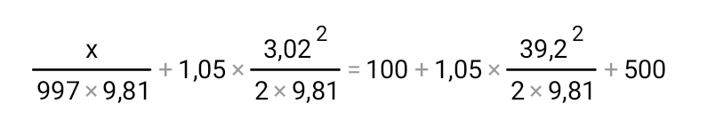

hello yes double-checking the calculations it is true, you are right, I have the wrong speed and consequently on point C the Reynolds number is wrong, your calculation is correct. My doubt is in addition to the continuous and localized pressure drops, the hydrostatic pressure, are there other factors that I have not considered in your opinion in calculating the force required by the piston to empty the tank?
Anyway thanks for your correction :)

The main thing you need to calculate is the pressure in the tank. To get the force, you just multiply by the cross sectional area.
The changes in calculation of velocities also affects the calculations in A and B.
Item D shouldn't be included; I have no idea what that is supposed to be.

Your receiving tank will end up with compressed air inside.
Your piston will pump a column of water.
At the end of the stroke, your piston must be resisting the increased pressure of the pocket of air plus the static column of water.
An instant before the end of the stoke, your piston will have to overcome the additional resistance of 48 cubic meters of water quickly moving inside the pipes.
Run those three calculations of pressure (two static and one dynamic), and add them all.
Then, the total pressure to overcome will give you the max pushing force of the piston.
Work and power calculation should consider the variation of pressure regarding stroke distance and time.
Could you share the solution values given in the textbook?

I must’ve missread post number 4. Still doesn’t make sense unless the tank at the top is vented to the atmosphere.
This problem seems very under designed to me. I'm having trouble believing this wasn't just made up. You have to compress the air volume (piping + upper tank) into a volume that is effectively the volume of the piping. Assuming ##P_o = P_{atm}## , that's like a final pressure of ##9 \rm{atm}##. The piston has an area of about ##50 \rm{m^2}## if I've estimated properly that is ##4.5 \cdot 10^7 N##! Just the force from that increase in gas pressure alone is absolutely tremendous. Also, because of this the flow will be unsteady. None of the standard (simplified) approaches for calculating head loss can be used.
I don't buy it.

the results in the book are force = 11100 N and piston power 660 kWh

ok i didn't consider the problem in this way, ok i calculated the pressure inside the tank with stevino's law P = q * g * h = 1000 kg / m3 * 9.81 m / s2 * 5m = 48903 Pascal. I then multiplied this pressure by the area of the tank 48 m2 and I obtained a force of 2347 kN so excluding the air and the pressure drops is this the force that the piston must exert?

Firstly, if you are compressing the gas, the force varies in time. So, asking for "the force" doesn't make sense? The force would start out as "back pressure" from viscous losses. That viscous loss back pressure would be quickly dominated by the increasing pressure of the gas.
If the answer in the book is a constant - ##11,100 \rm{N}##, then this system has to be vented, and the flow is assumed steady.
at this point seeing that the result is to you where the force is much greater than the result, it makes me think then that I was wrong and the tank at the top is open, but heck it is not written anywhere that it is open on the exercise and also from the scheme that I have copied you can see that it is closed, I am having a doubt now

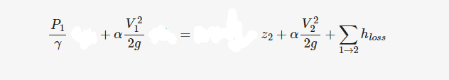

$$ \frac{P_1}{\gamma} + z_1 + \alpha\frac{V_1^2}{2g} + h_p = h_t + \frac{P_2}{\gamma} + z_2 + \alpha\frac{V_2^2}{2g} + \sum_{1 \to 2} h_{loss} $$
##h_p## is pump head
##h_t## is turbine head
## \alpha## is the kinetic energy correction factor (turbulent flow ## \alpha \approx 1.05## , laminar flow ##\alpha = 2##)
## \sum h_{loss}## is the total head loss between ##(1)## to ##(2)##
You are also going to use continuity for incompressible flow:
$$Q = V_1 A_1 = V_2 A_2$$
You are going to simplify what is above, and solve for ##P_1##, which will be the pressure acting over the surface of the piston.

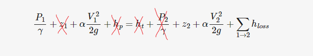

@erobz
ok I tried again with the calculation, I eliminated from the equation the factors that are not present in the problem, so z1 / hp / ht / P2 as it is 0.
V1 = 3.02 m / s (speed in the section of 0.9 m) calculated with the flow rate of 1.92 m3 / s
V2 = 39.2 m / s (speed in the section of 0,25m) calculated from the flow rate of 1.92 m3 / s
With these speeds I calculated the continuous and localized pressure drops for a total of 500 meters of water column
in the end the formula comes to me like this
where x = P1
in the end the result is P1 = 6 670 000 Pascal

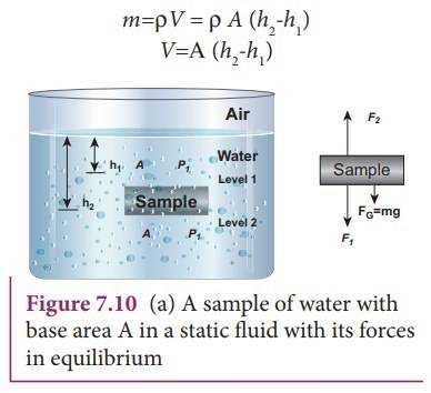

The diameter of the pipes carrying the flowing water are only relevant when estimating the resistance that those present to that flow.
Only the height of the vertical column of water matters, regarding hydrostatic (non-moving fluid) pressure.
Please, see:
https://en.wikipedia.org/wiki/Torricelli's_law
https://en.wikipedia.org/wiki/Pascal's_law
Not considering the final pressure of the compressed air in the spherical top tank (assuming that the top tank is open to the atmosphere), the value of the static pressure along the horizontal line that runs through the centers of the blue tank, the 0.9 m diameter pipe and the horizontal section and elbow of the 0.25 m diameter pipe would be the same: ##980.64~kPa## or ##980.64~N/m^2##.
Since ##P=F/A##, that pressure would push the ##48~m^2## piston with a force of ##47040~kN##.
Yes, the walls of the 0.25 m diameter pipe will be "feeling" that same pressure, as well as the masses of fluid located directly forward and after that section.
Please, see:
https://courses.lumenlearning.com/suny-osuniversityphysics/chapter/14-1-fluids-density-and-pressure/
  • #50
Perhaps the length of the vertical pipe could be 10 meters rather than 100?
A 10-meter water column would induce a static pressure of ##98.06 ~kN/m^2## on the piston.
Please, see attached PDF drawing at scale to appreciate the real dimensions of the problem as shown at post #1.
