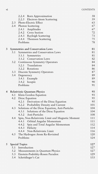

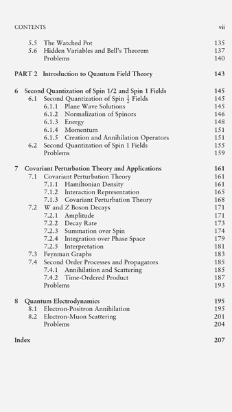

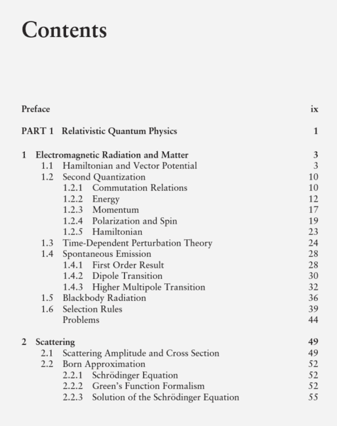

I happen to have the contents of the book:
N.B.: Please don't penalise me for posting the contents. I haven't posted anything of the interiors of the book. This will simply help the readers to understand whether the book will be of help for them.
Thank you! Saw the contents on amazon as well.
Likes Wrichik Basu
