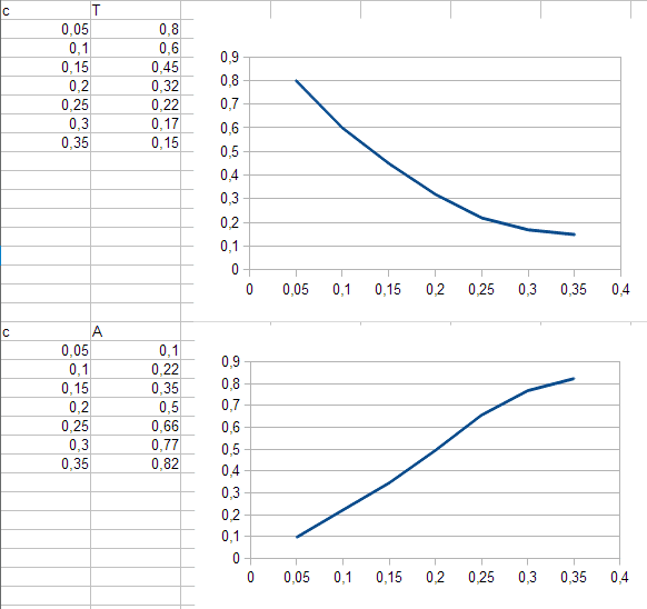

Have you tried to plot A vs c?
I have converted the values based on approximation of the values given on the graph (just have the graph).
Values based on my eyeball view:
% T values (concentration) => 80% (0.05%), 60% (0.10%); 45% (0.15%), 32% (0.20%), 22% (0.25%), 17% (0.30%), 15% (0.35%)
conversion:
Abs value (concentration) => 0.0969 (0.05%), 0.2218 (0.10%); 0.346 (0.15%), 0.495 (0.20%), 0.657 (0.25%), 0.769 (0.30%), 0.824 (0.35%)
Revelation: nothing much
It looks the exact same as the transmittance except with a positive sloping graph when abs is plotted. Of course, the last value deviates from beers law but that is because it is at a higher concentration I guess.
Strange. Neither plot looks completely linear, but T plot shows an obvious curvature, so I would prefer A plot. Unless some more advanced statistical analysis would point to T. Not that I have any idea what "more advanced" analysis could mean.
Hm, It looks exactly the same to me as it is plotted except they just used linear regression to find the best fit line which left the last point out. It was a bit straighter though.
I just noticed something odd I didn't take notice of before for some reason. This may be why it was strange when you plotted it. The scale on the y-axis is not spaced evenly. I measured the spacing btw the %T values and it is as follows:
10-20%T (2cm), 20-30%T (1.2cm), 30-40%T (0.8cm), 40-50%T (0.65cm), 50-60%T(0.5cm), 60-70% (0.4cm), 70-80% (0.4cm), 80-90%T (0.35cm), 90-100%T (0.4cm)
Now I'm even more perplexed about the problem.
I'm not sure about the relationship between the numbers and isn't an axis usually spaced evenly? Is there any case where this would not happen like for my graph?
Thanks Borek
Sounds like a special graph paper - they come in many flavors, so that you don't have to convert your data. Google for logarithmic paper and you will see what I mean.
Likes 1 person
Ah, that makes sense since that is what it was. I haven't seen something like this before. This explains what I'm seeing and probably the question I guess.
Thanks Borek!
